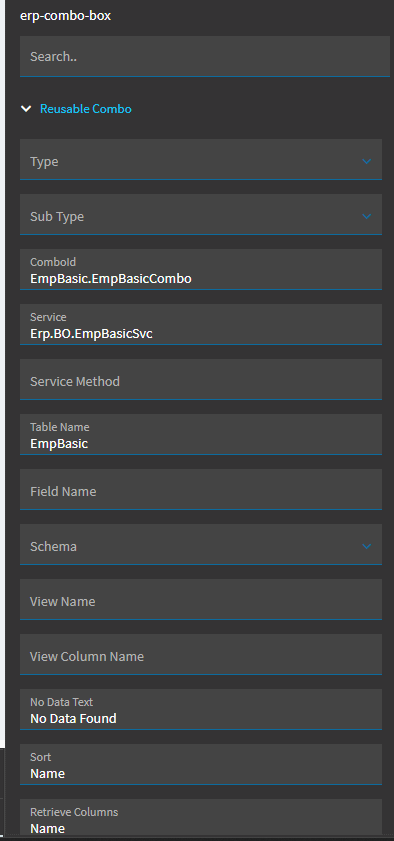

Trying to setup a Combo box that is populated by a BAQ. I’ve done this before. Can’t figure out what I’m doing wrong now. I get “No Data Found”. I did set this up as a Key Field. Is that my issue? Everything under Reusable Combo is blank.
Well im fairly new to all of this myself, but if im not mistaken(I could be) you need to add this under reusable combo properties.
Match it with your table.
Hi Dan,
Please clear the Reusable Combo properties by selecting null for the Reusable Combo field.
After that, use the Advanced Properties option and try to preview the result.
Sorry I just realized my suggestion was pretty far off, I used those settings and linked a BAQ earlier and looked at the wrong combo box. what you have done in your first images is exactly what I did and it worked for me :man_shrugging:. Thats a weird one
