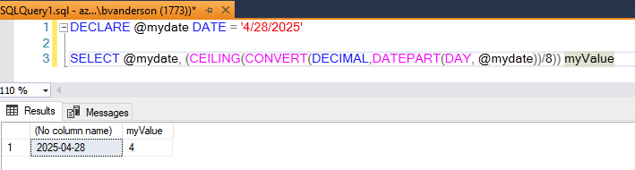

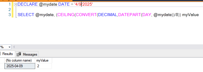

Wouldn’t it just be easier to divide the day by 8 then round up in a calculated field?
So your calculated field would look like this.
(CEILING(CONVERT(DECIMAL,DATEPART(DAY, @mydate))/8))

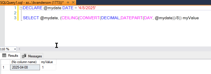

Rounding up won’t increment even multiples of 8.
cast(datepart(day, <date>) / 8 as int) + 1
What’s happening there - Casting a decimal to integer truncates the decimal.
So if it’s the 7th, dividing by 8 produces 0.875, casting that to int truncates it to 0, add 1 and you’ve got your week (where week count starts at one).
Seems to work when I test it.

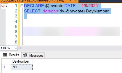

or are you just looking for the weeknumber by year, split up into 8 day segments?
If that’s the case, you can use the dy to get the day number of the year, and do the same with ceiling and divide by 8.

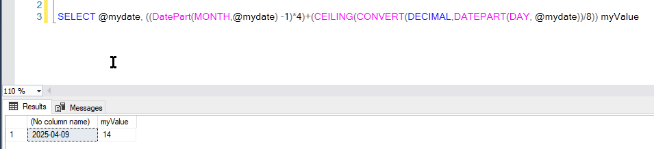

why doesn’t this work?
((DatePart(month,@myDate) -1)*4)+(CEILING(CONVERT(DECIMAL,DATEPART(DAY, @mydate))/8))
Why do you think you need a CTE? CTEs are necessary when a record DEPENDS on the preceding record. Like in a BOM, I know it’s level 3 BECAUSE the previous one was level 2. Without the previous record, I don’t know what level this record is.
In your case though, it’s purely a single record, and the week number based on a calendar. If I have no records in week 6, there can still be records in week 7. It has nothing to do with the previous records, so why would you need a recursive query?
This part gets you the previous number of weeks in months before (assuming each month is 4 weeks)
And this part gets you what week it is in the current month.
So you add the 2 together, and you get the current week.
date 4-10-2025
Month part
month = 4
4-1 = 3
3*4 = 12
So you have 12 weeks for Jan, Feb, and March. Regardless of how many days are in the last week.
day part
day = 10
10/8 = 1.25
ceiling = 2
so this is week 2 in month 4
2+12 = 14.
That date is in week 14.
What isn’t right there?
