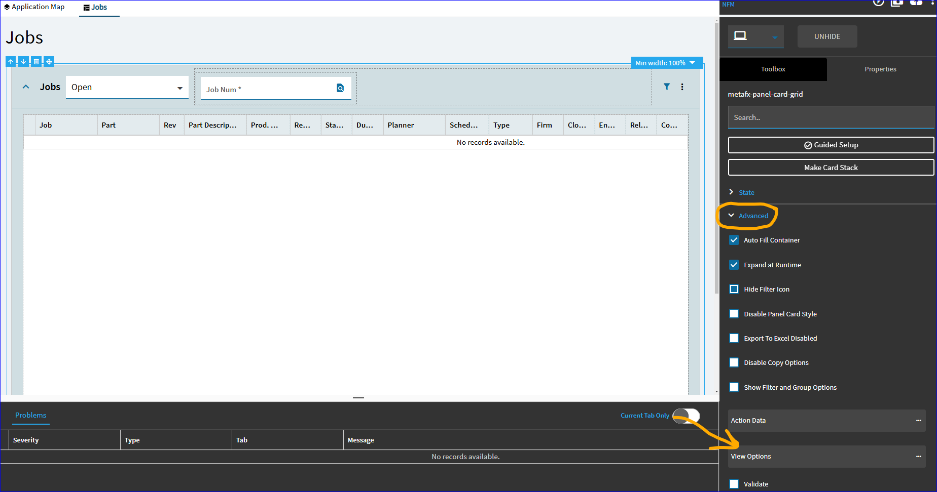

On your landing page… could you not add a View Option (under the grid’s advanced properties) which filters the jobs? Then you just make that View the default.

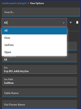

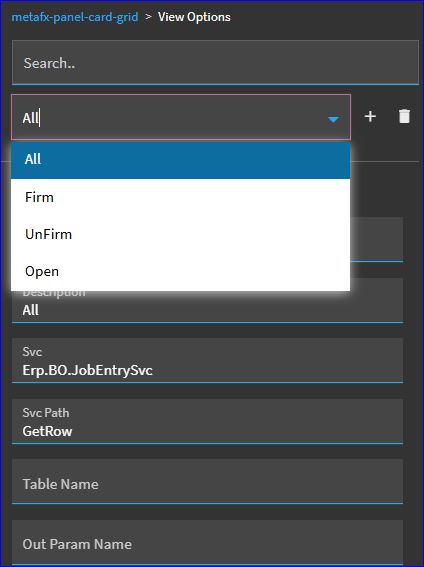

A lot of stock forms use it… here’s Job Entry Landing Page as an example:
In the View Options, you set up whatever views you want… Job Entry has (4) in this case, each with its own criteria. So when a user changes Views it reruns the service and repopulates the grid.

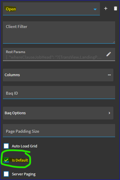

And when you have multiple views, further down in the settings… pick one and make it the default (in this Job Entry case, it is the Open view):
