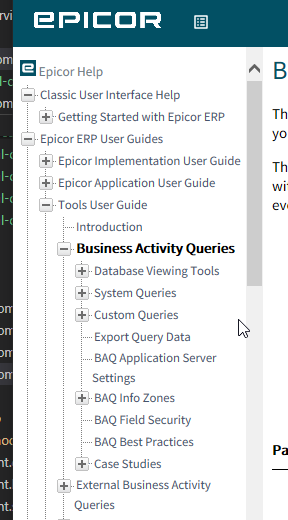

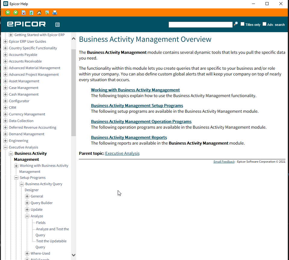

The help file has pretty good explanations of most of the things in the BAQs.

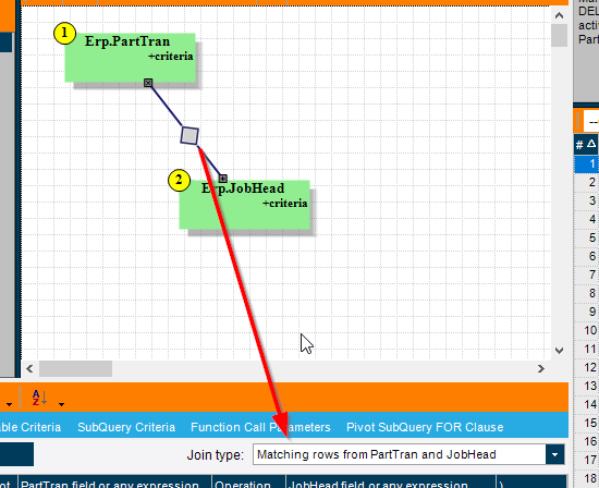

For your specific question, it’s the dropdown that shows up here when you click on the join.
@NateS , the tools guide is now in the help file. So you don’t need to go to Epic web anymore.
You can find the Join Type in the BAQ Designer. Make sure you are in Business Activity Query Designer, not the BAQ report designer.
From there, look at the Query Builder Tab. Then look in the bottom right corner to find a drop down list of the join types. Join two tables with the little chain link icon in the top left. Choose the line that joins the two tables together, and change the join type with that drop down box.
