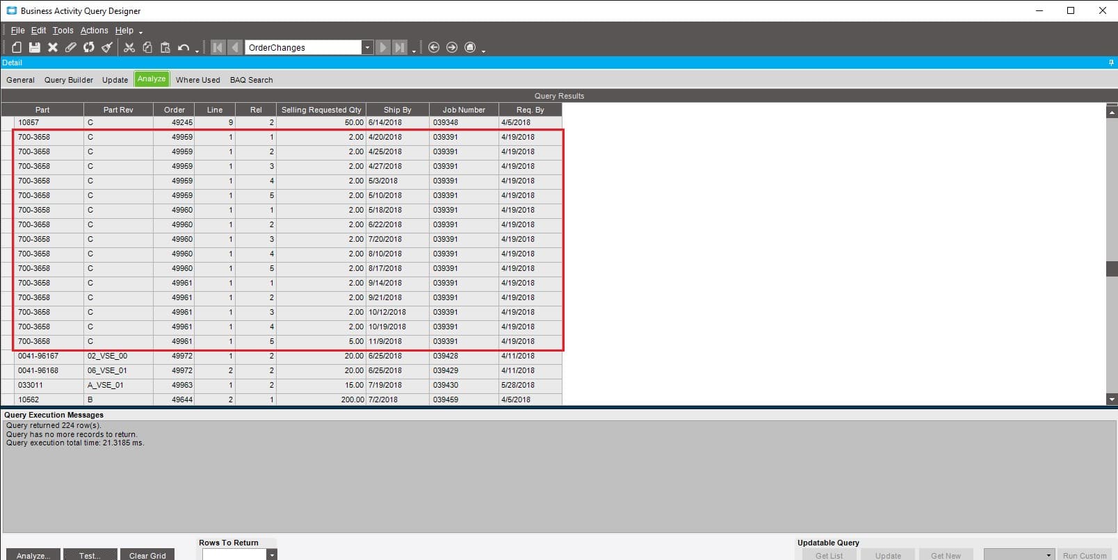

I am trying to build a BAQ to show when a jobs Req By date does not match the date of the next open order to be shipped (earliest open Ship By date in the job demand summary)
What I want the row to return is:
Part #
Revision
Order #
Order Line
Order Release
Release Qty
Release Ship By date
Job #
Job Req By date
Currently I have a single SubQuery and is setup as follows.

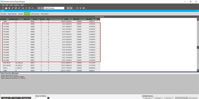

Currently when testing, this results in returning rows for all releases on the job with a Ship By date that do not match the jobs Req By date as shown bellow.
So far I have been unable to figure out how to only return the row with the earliest Ship By date related to that job. I have been unable to create a table criteria to achieve this. I have also tried setting this SubQuery to an inner query and creating a separate top level with a calculated field to get the min ReqDate from the current results but have not had any success with that either. If anyone has any insight as to how I might find a resolution to this or maybe a different approach all together I would appreciate the feedback.
