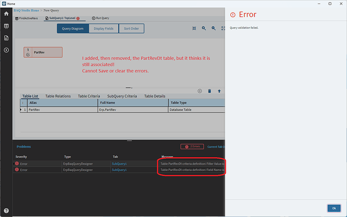

I am probably missing some simple trick, but when I add an additional table to the BAQ Query Designer (Kinetic Screen in Client Version) then remove it, the system still thinks that table is related and will not allow save or a way to “Refresh” it even though the table was deleted.
I tried the “Reset Field Attributes Cache” and that did not work.
Frustrating to work on a BAQ then not be able to save it because you removed a table and it thinks it is still there. None of the tabs or sub-queries show the table, just the error that no criteria is set for the deleted table, lol
Cloud Based 2023.2.6 Client Install Kinetic BAQ Designer Screen.
