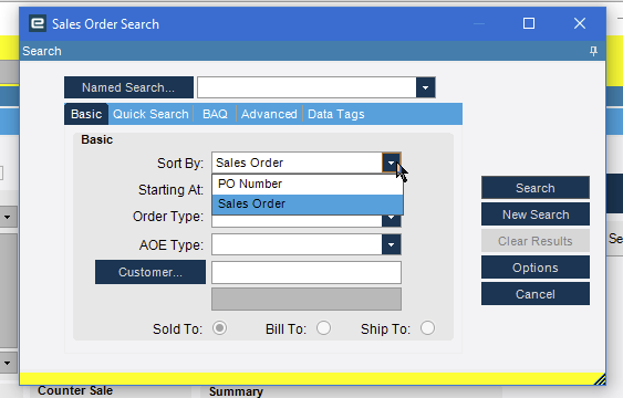

I’m assuming they just want the same type of search that shows up in order entry, which allows you to search by Customer PO number by changing that drop down.
I never knew that was there. I was thinking that usually, if I’m searching for something by a Customer PO Number, I already know my PO Number. So I can just enter it. If I’m searching for it, I’m only searching for it to find my Order Number, you know? So search based on the order, rather than the PO. That was my logic. But at the request of the natives here, I was trying to understand the bigger picture rather than just the zoomed in problem. :slight_smile:
yeah, the reason I knew it was there, is my users asked for the same thing, but I don’t know how to recreate that special search they have going on there. It’s common if you are working with a customer to be referring to their PO number, so it makes sense to be able to search by it.
If you do your own BAQ or quick search, you can just add it as another field, but it’s a little more cluttered than the stock way they have it.
