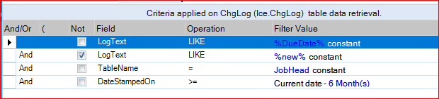

You can pull the Ice.ChgLog table into your BAQ.
This is on due date, but should get you started.

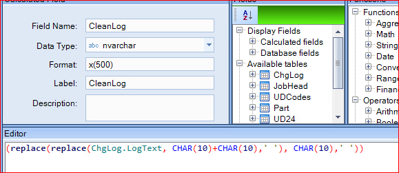

To get the log in one string, so you can parse it do a replace like this.
Criteria like this but with Closed
then once you have the cleanlog you need to use something like carindex and substring to get the time from the string.

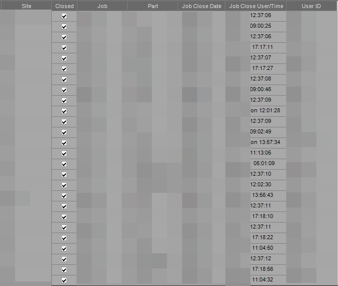

Got this info pulled in now, thanks to your guidance, thank you - another quick question. If I wanted to trim out all of the extra details and only include the time in standard (non military) format. Any ideas how to do that?
I could not parse to that level with my sql skills so I made the baq updatable and the below code routine post processing on GetList to get my dates. You can do something similar to get the time out.
