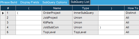

I need to essentially “append” the outsourced operations list to the materials list, then resort so that operations are at the top for each material. I’m at a loss on how to union the two queries. Any help would be greatly appreciated!

I didn’t open your BAQ’s. But if you want to union them, use the ( ) in the subquery list to group the sections together. One will have the top level, and the other with be a Union or Union All.
Both of the queries will need to have the same number and type of fields for that to work.
Thanks Brandon!
