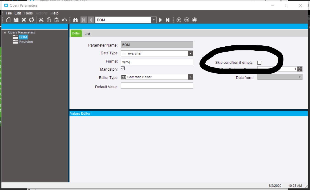

I’ll need a better example of what you are trying to do.
if you are talking about the BAQ parameter. You can check the skip condition if empty checkbox.
