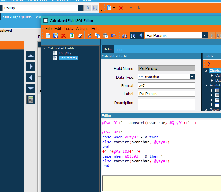

Here’s a calculated field with part number and quantities.
Updated version - Thanks now to add the other @Part & @Qty then publish as a dashboard and a BAQReport
