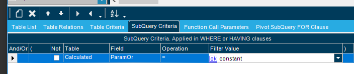

You could use the 2 parameters to in a calculated field, and then filter the results by that column.
case
when @PartNum1 <> '' then 'ok'
when @PartNum2 <> '' then 'ok'
else 'not ok'
end
Put whatever parameters you have in there, then use subquery filter to set that the row only comes back with “ok”. Then if they are both blank, it doesn’t return any rows.
