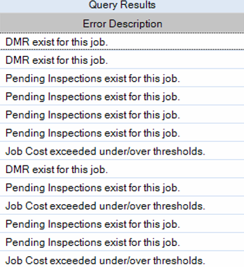

Just posted about this here.
Once you go over @Banderson guide this information is in the JobClosingLog table. If you use auto complete and auto close any jobs that can’t complete or close with an exception are here.
