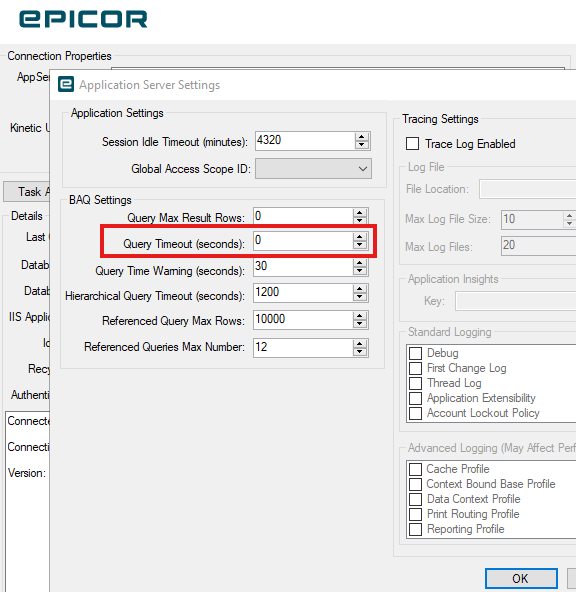

check your Query Timeout settings on your app server. It reset mine to 0 when I upgraded to 2024. I think being set to 0 actually times out at 30 seconds.

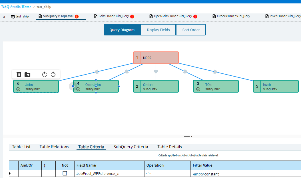

Also, try making these UD Columns table criteria into calculated fields and in the case of an empty string, put something else there. It’s quicker for a computer to find something than nothing.

thanks for that. ours was set to 0 for the query timeout settings. what do you recommend setting it at?
I have updated it so it isn’t filtering on the empty

whatever floats your boat. I set mine to 300. Don’t forget to recycle the app pool or else it won’t apply!

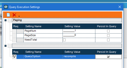

One of the new features is to be able to add option(recompile) to your query. Using the execution settings. This doesn’t always fix the issue, but when it does, the results can be dramatic.
