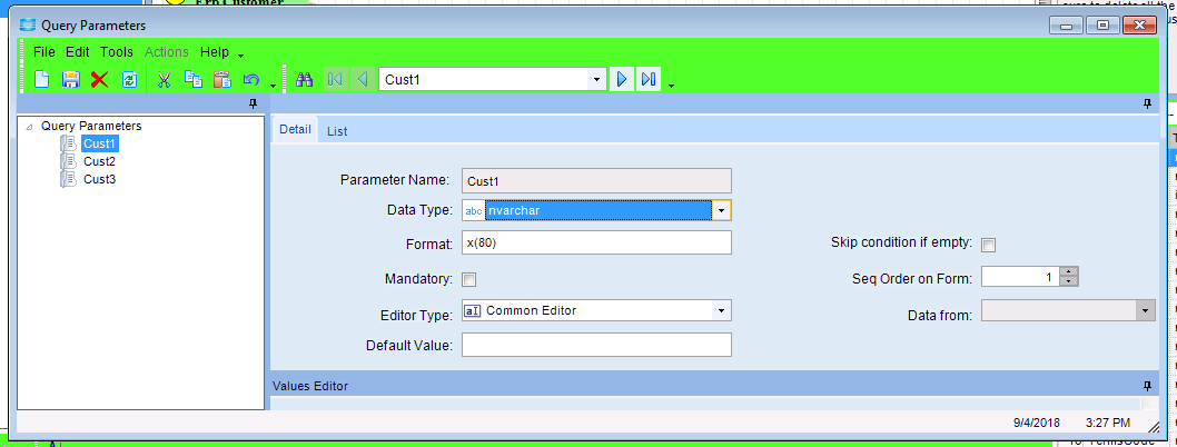

Define 8 Parameters like (I only did the first 3):
Add table criteria to Customer table
Blank params are ignored:

If you go down this route. I would probably check the skip condition if empty, for when you don’t have all parameters with data.
Since it’s an OR based criteria, it doesn’t matter. Or does it affect the running time of the BAQ?
But that “skip condition” option does throw me sometimes.
