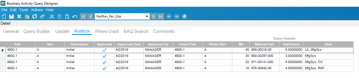

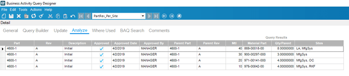

Here’s an example using the Education DB.
This will at least show you if certain sites aren’t added in PartPlant.

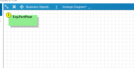

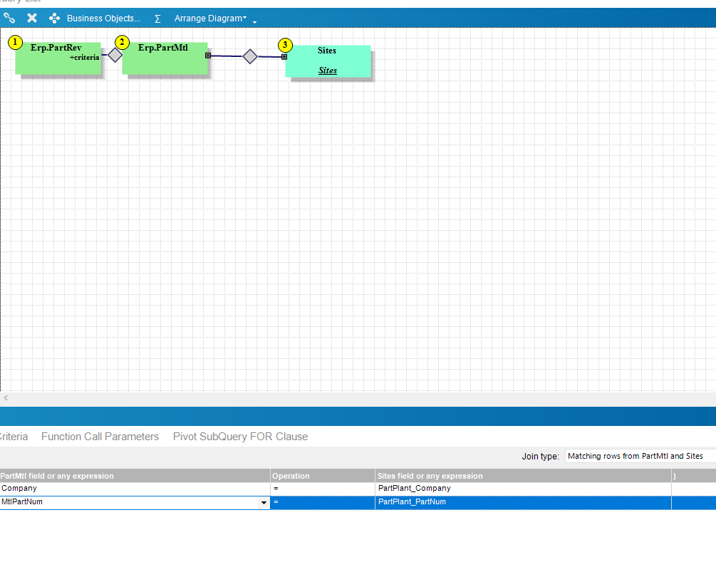

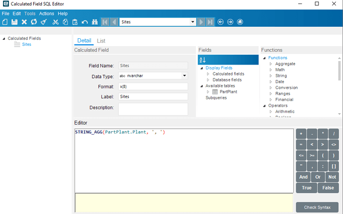

So the top level of this BAQ has PartRev and PartMtl. Then it has a Subquery joined on PartMtl.
the subquery has PartPlant and just three display fields.

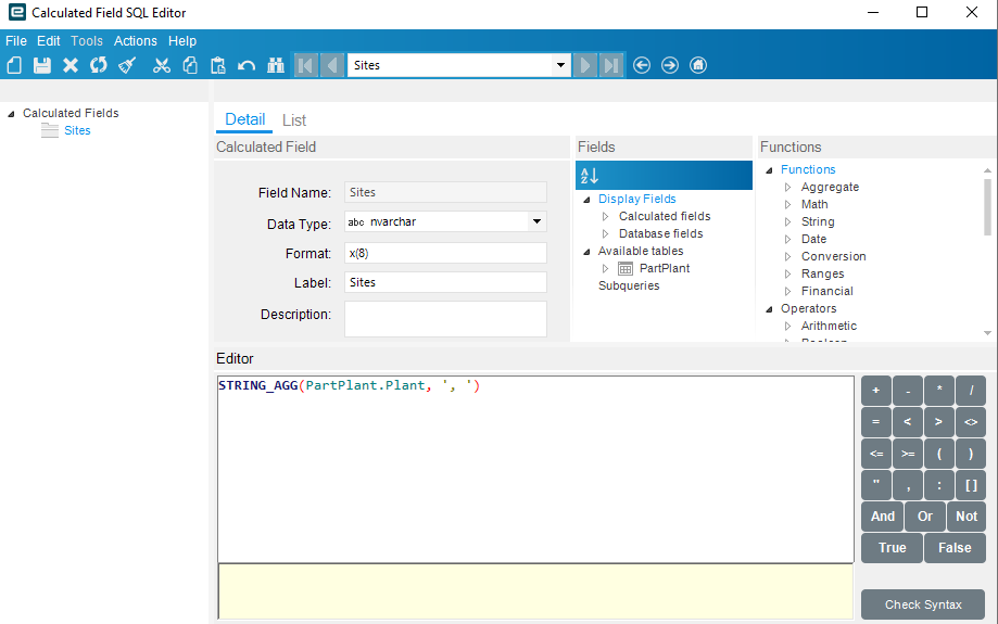

If you could show me how you did that then I would have what I’m looking for.

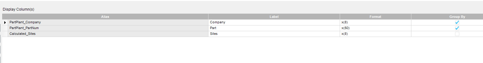

The calculated field is STRING_AGG(PartPlant.Plant, ', ') just group by on the other fields.
Let me know if you have any other questions. Cheers.
@Fernando, just what I needed!! I got it to work on my BAQ for indented BOM, so it goes all the way from top to bottom!
Got another calc field to say if it’s set-up or needs set-up, so i can filter on that in the Dashboard after I do some more testing.
