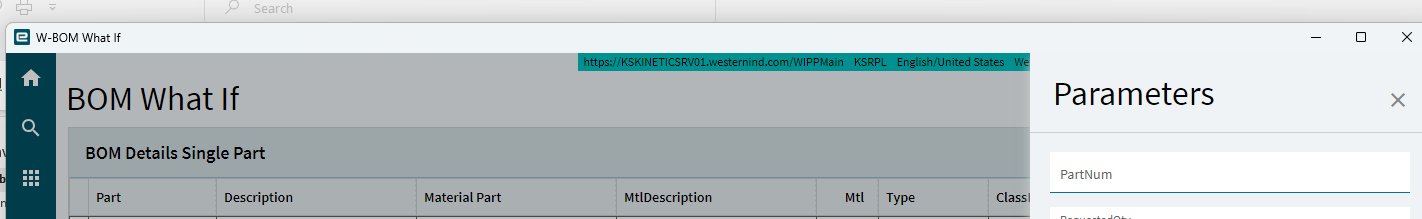

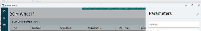

You can replace the slider with on screen components like so:

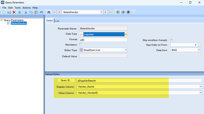

Hi Robert,
While this won’t give the full search dialog, it would provide a list of part numbers or description, whatever on part you’d want, in list view. This is an example using supplier. It allows typing / matching in list. Just a thought…
