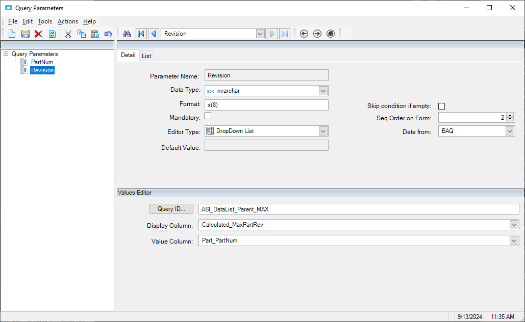

We have a BOM query that we pass the part number and rev as parameters that the user enters. Our users have requested we pre-fill the rev with the max rev after entering the part. I know I can use my max query to get the max rev, but how do I tie it to the part number entered? I have it set like this, but I don’t know how to have it refresh the Revision after the user puts in the part number. I want to display it so they can change it if they don’t want the max revision.

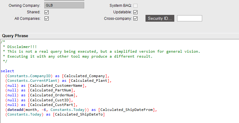

You can prefill in Query Parameters with BAQ Markup Syntax. As long as you have the PartNum you should be able to use Part.PartNum in your Values BAQ.

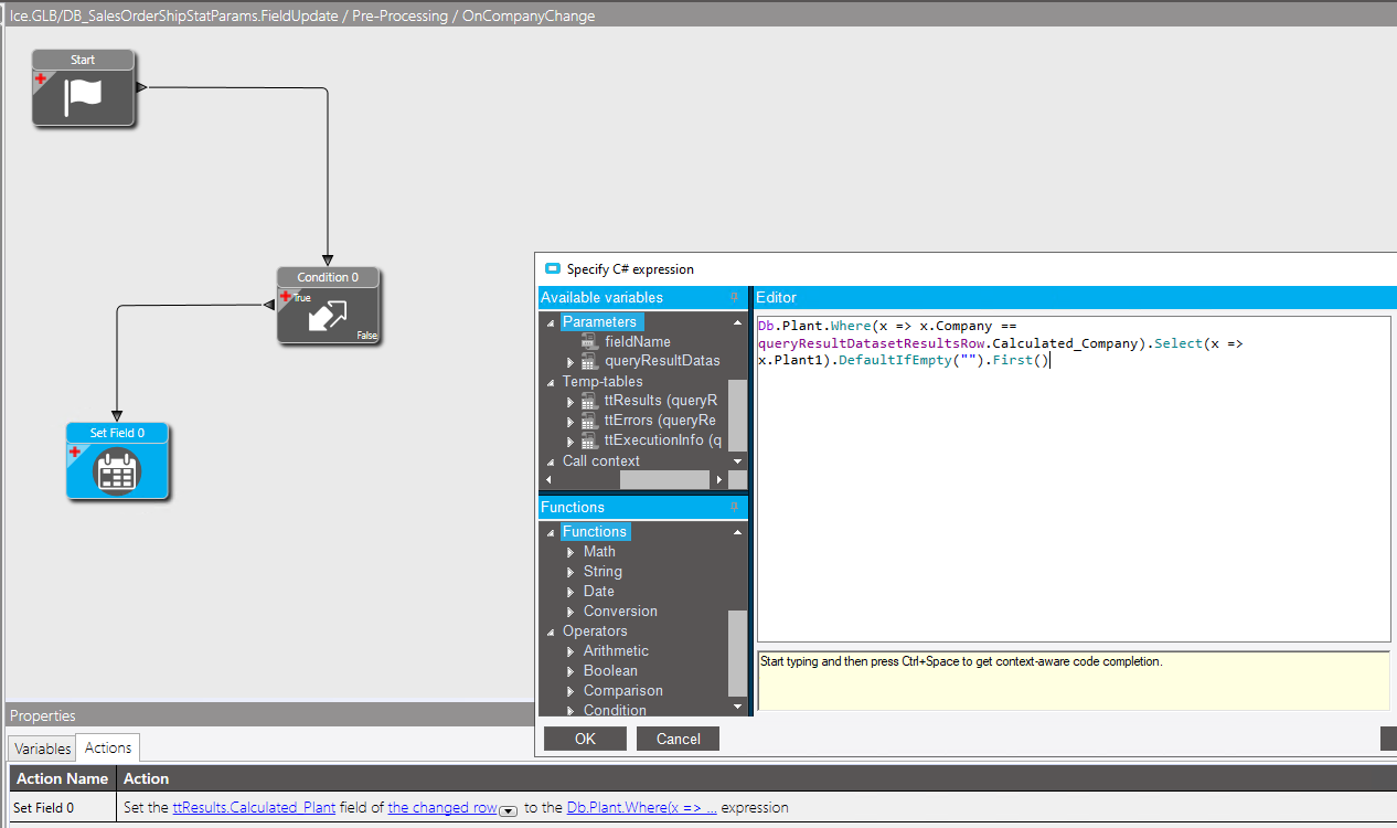

Second if you mark the BAQ a Updatable BAQ you can do BPMs on it. Do stuff on FieldChange Events.
Third if you make a BAQ MyBaqParams and the Params is just Calculated_Fields you can mark it Updatable, assign it in 10.2.600 as Main BAQ in a Dashboard and Publish Parameters (not filters) to the other BAQs such as MyBaqHead and MyBaqDetail

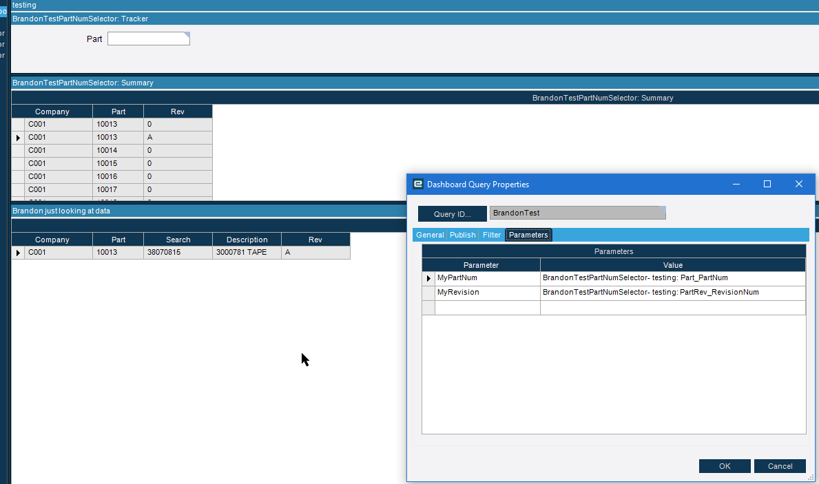

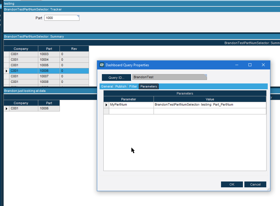

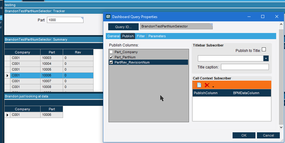

Maybe this would work for you. You can set parameters using the publish and subscribe. So you can make a small “selector” baq, then publish the part number and revision, then in the CTE grid you can subscribe to those values.
To publish, click on properties on the query (not the grid) and you’ll see a publish tab. Click on the fields you want to send to your CTE.
On the CTE click on the properties of the BAQ (again, not the grid) and go to the parameters tab. You’re parameters should show up there, and you can assign your published values to parameters.
I believe that should do what you want. And no complicated customizations to make it work!

The parameters are in my version but it still isn’t doing what I want. I used my query to get the max rev, which prompts for the part number. After entering the part number it automatically gets the max rev and fills the IBOM part of the dashboard (linked with the published fields). The problem is I want it to be a 2-step process. The user enters the part number, the first query returns the rev, then the user can change it or leave it with the max and do the refresh to get the proper IBOM.
I have the basics of it working from a customized form but the fact that the CTE query has to have parameters is keeping it from working.
Make the first selection query return a list of part numbers and revs. Then publish both, and use both of them in the parameters.
Sort your selection query so that the “max” (however you define it) is listed first. Then when they refresh, it should publish the first row. If they want to look at another rev, they just pick a different row.
