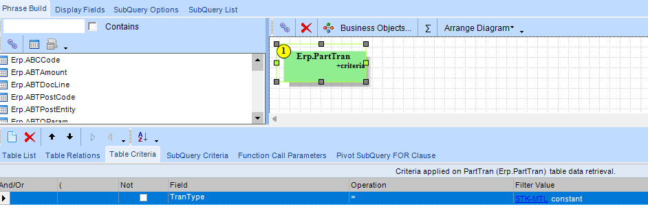

1st Query (InnerSubQuery)
Start with a query of only the PartTran table. Add a Table Criteria so it only returns records where TranType = STK-MTL

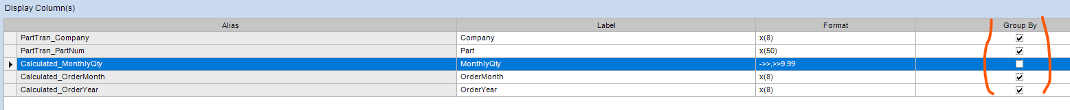

Here are my display columns:

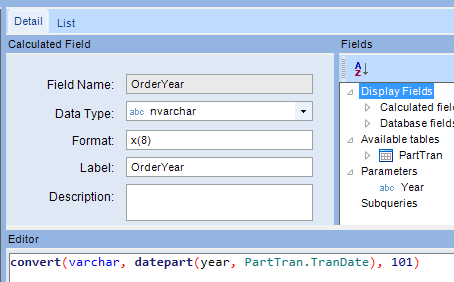

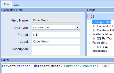

Note… I don’t know why I called them “OrderMonth” and “OrderYear”… this has nothing to do with “Orders”… so, may want to give them a better name. I think I was thinking about Purchase Orders while I was putting this together.

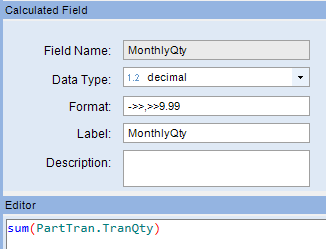

Calc Fields:
Because your MonthlyQty is a aggregate calculated field, you’ll need to “Group By” all the others:

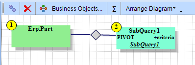

2nd Query (Top Level)
I pulled in the Part Table and then joined the 1st query on Company = Company and PartNum = PartNum

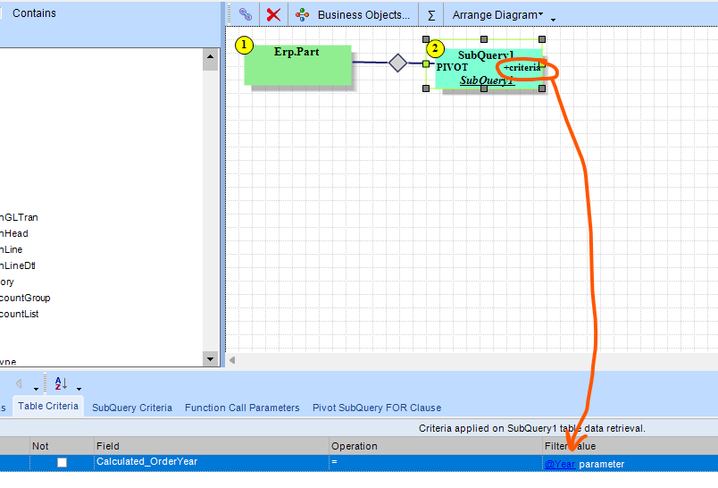

I created a Parameter called Year:
Then added that to the subquery’s Table Criteria, that way, it will only return records where the OrderYear = the year typed into the Parameter.

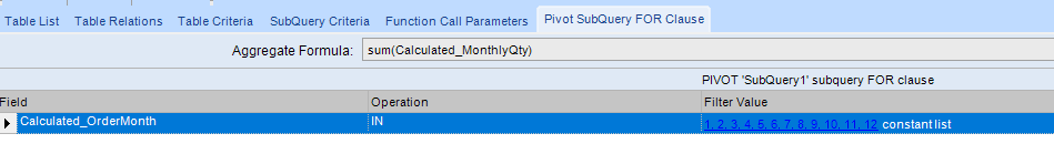

Here is the Pivot added to that subquery:
So, I’m summing the Calculated_MonthlyQty)… based on OrderMonth IN a constant list where I just manually added columns 1 - 12 to the constant list.

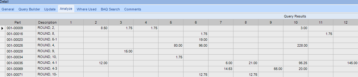

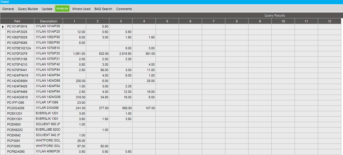

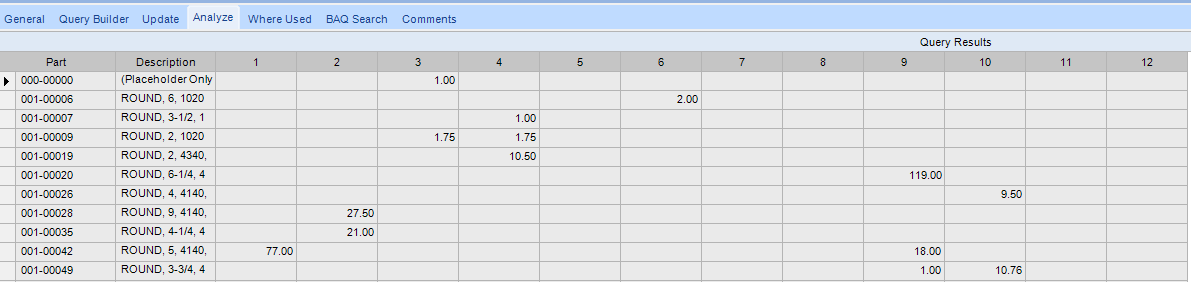

Testing the query, I get these results… it prompts me for a year:
2023:
2024:
So, you can see the sum values change depending on the year you enter.

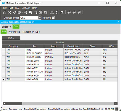

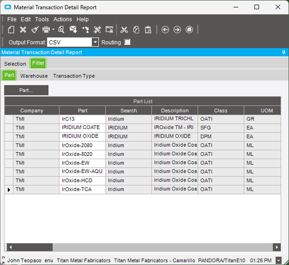

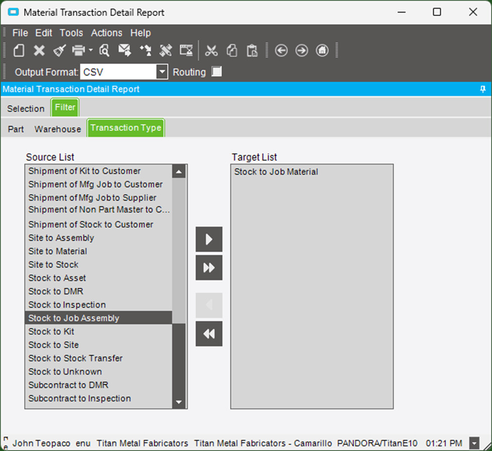

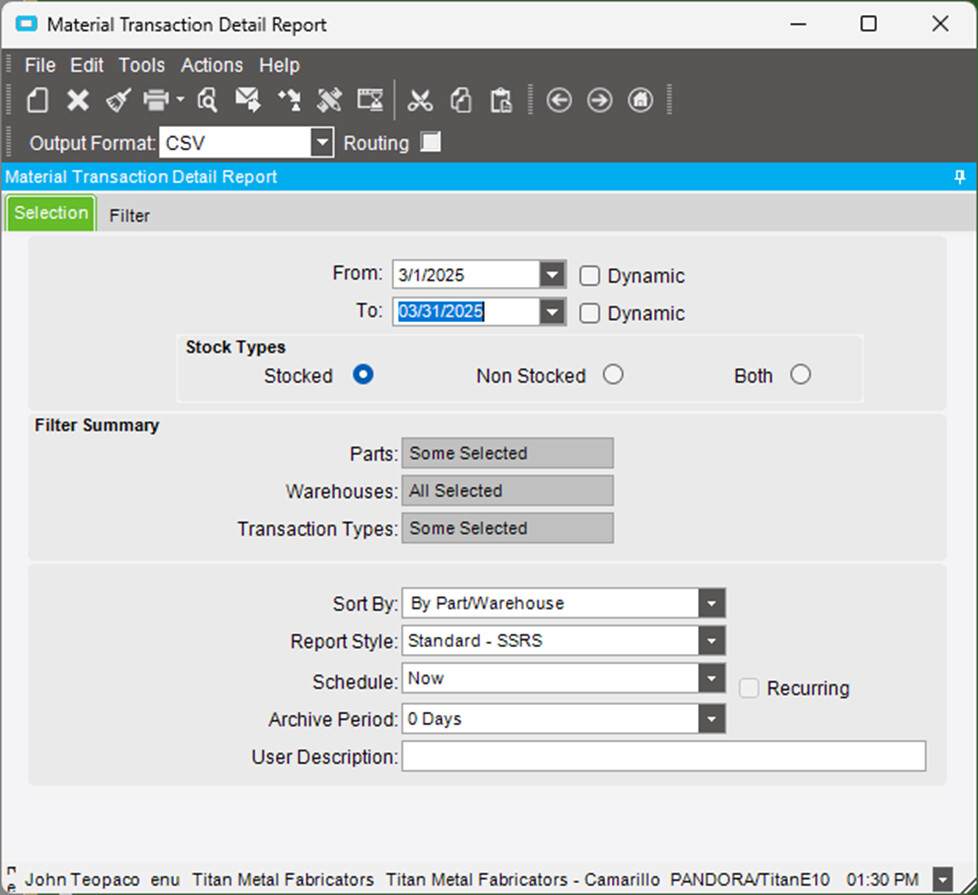

If you are NOT a database/IT person (I am an accounting/finance guy)
You can use the report that is already in the system…
Material Management > Inventory Management > Reports > Material Transaction Detail
Output Format = CSV
Enter your dates
Go to "Filter " tab, then “Transaction Type”
Go to “Part” tab
Enter your part or parts
click “Print Preview or Generate Only”
Lastly, if you have your schedule setup you can have this report AUTO-GENERATE at EOM.
