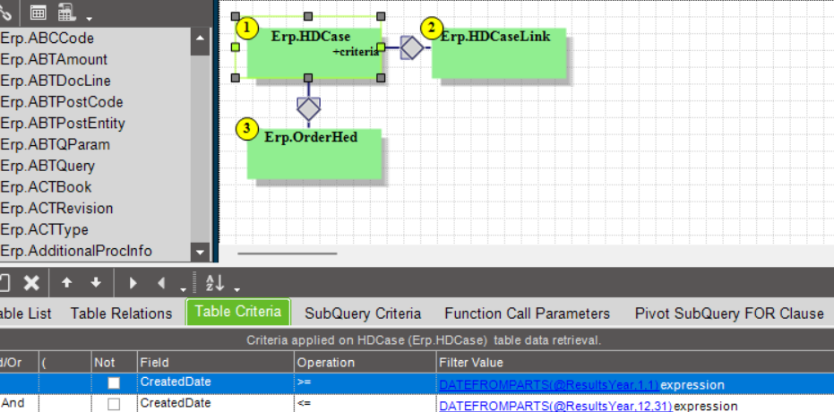

Hopefully that’s not something new in 2024.1 … in 2023.2, it’s in the dropdown menu at the top-right of the BAQ designer:

Small reminder how to filter dates efficiently
