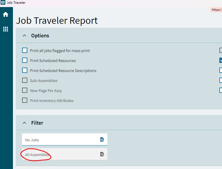

I am trying to add a Quick Search to a Filter for Assemblies for the Job Traveler Report. I’ve seen @hmwillett’s posts about needing to use dataview-filter-set along with row-update, and multi-selects needing a loop, etc. However, I’m doing something wrong.
My event is firing, the right search is coming up.
The search show is bound to a dataset named QS_JobOperations.
I’ve tried to set the dataview-filter-set to this:
and the row-update to this:
What should the settings for the filter be, and what should the settings for the row-update be?

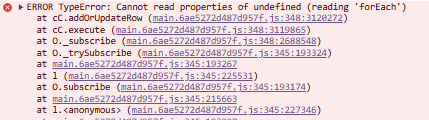

Upon returning from the search, getting this error:
Thank you for your help.
I think you need single quotes and curly braces in your filter.
Try: JobAsmbl_JobNum = '{searchResult.JobNum}'
David, I wish it were that easy, but that wasn’t the solution. Thanks.
