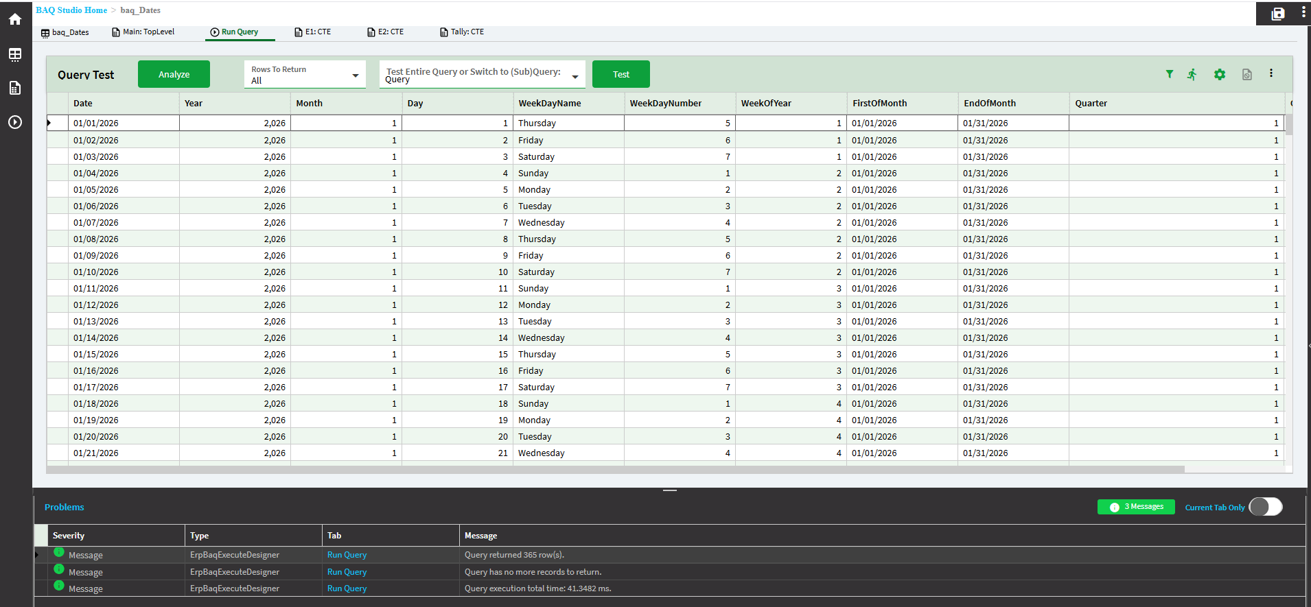

I have a BAQ with 3 parameters Company, StartDate, EndDate which runs fine.
However, I cannot get it to execute in another BAQ (having the same params) as a Referenced Query.

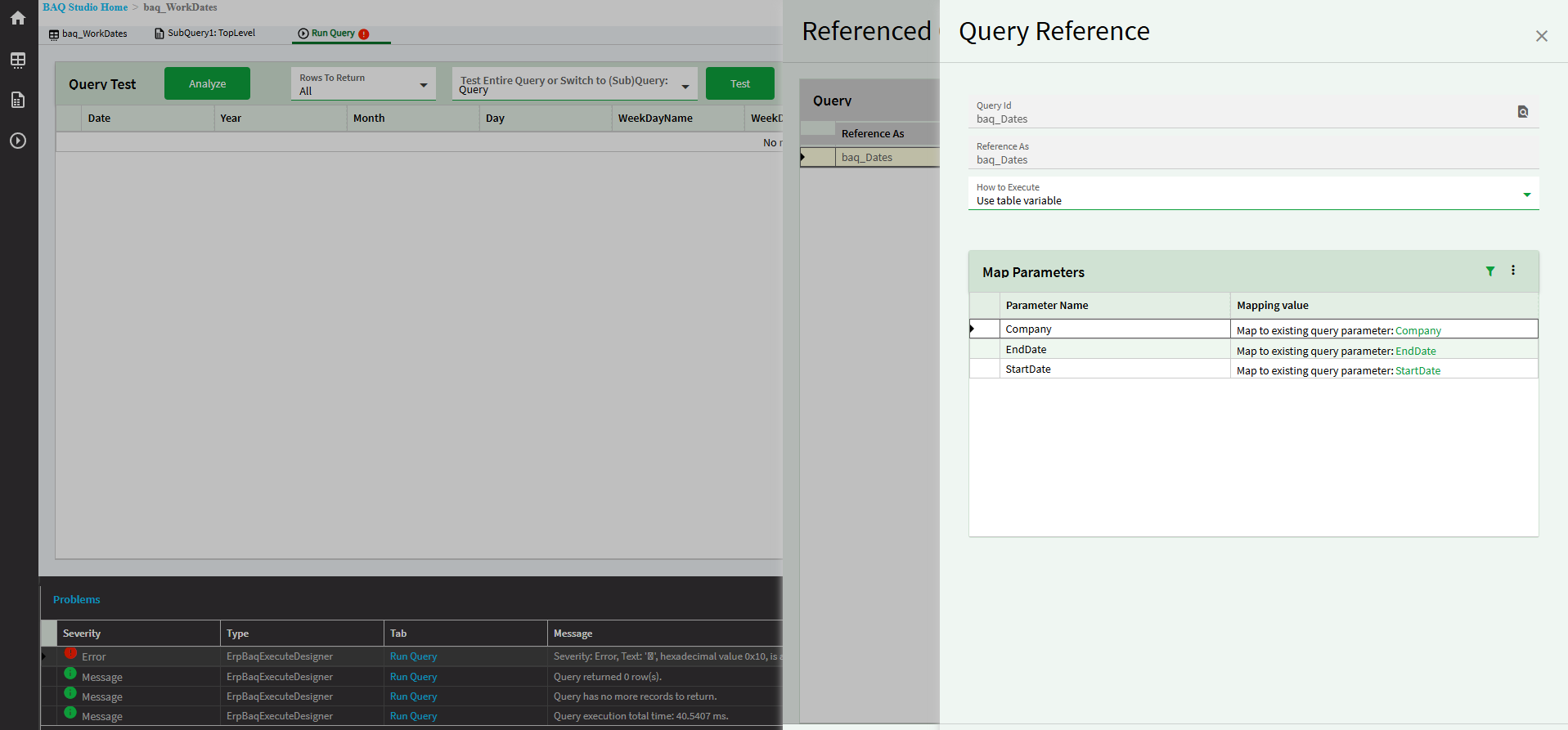

Error:
Severity: Error, Text: '', hexadecimal value 0x10, is an invalid character.
First attempt to use a referenced query. Am I doing this wrong?
Are all the parameters the exact same data types? Seems very picky i.e. date will not map to datetime, shortdateyear will not map to date, etc.
Thanks Alisa for your reply. Yes they are exactly the same data types.
What if you tried setting each parameter to blank, saving the query, then going back in and remapping them manually? I sometimes find that Kinetic doesn’t like to map the parameters properly when they’re defaulted, so I have to manually reset them like this to get everything working.

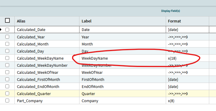

Try to extend this calc field format = field width. This worked for me
Wednesday has nine letters. HA! Thanks!

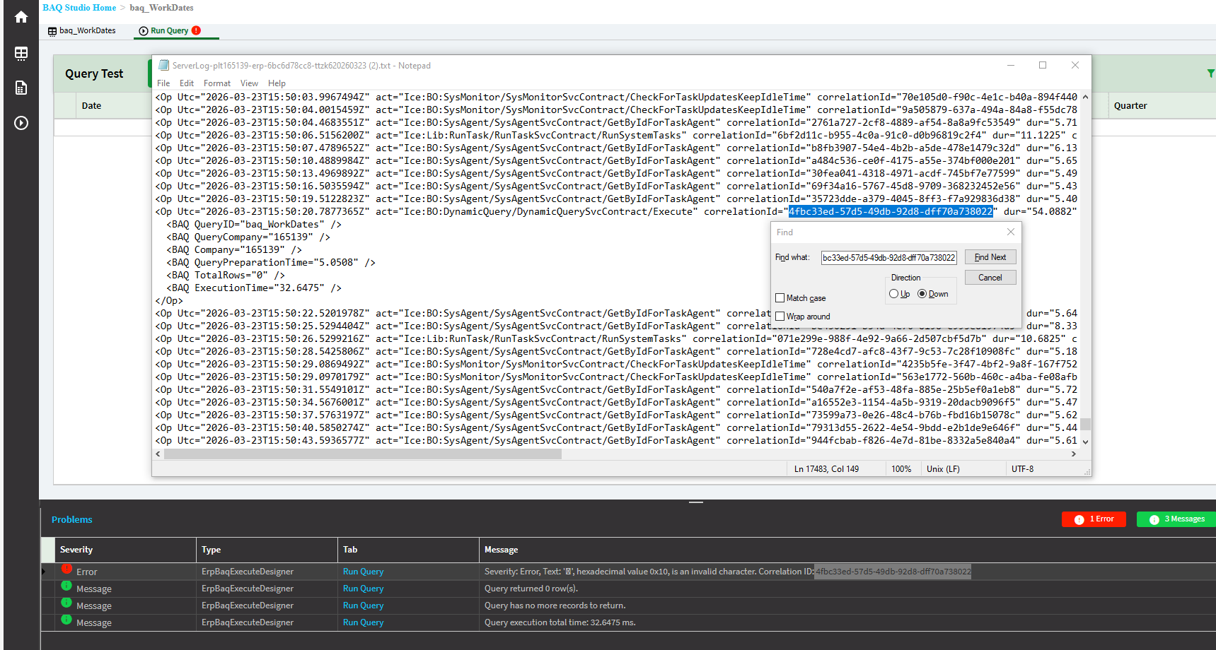

also when you are in error log, please tell the full error for the case
Severity: Error, Text: ‘’, hexadecimal value 0x10
it does not seem related to BAQ
I don’t find that hexadecimal error in the log. Only the truncation error like yours.
So I broke the query again so I could search by correlationID.
The hex error indeed doesn’t exist in the log. In fact the CID is found but the log looks like a good exec without error.
This happens and seems repeatable on first test run after a page refresh. Upon second test run I get the truncation error.
what is in the browser dev tools tab, what does server return exactly? maybe it fails to process the error? #10 looks like some new line stuff
    "returnObj": {
        "Results": [],
        "Errors": [
                "ErrorType": "Error",
                "ErrorText": "'\u0010', hexadecimal value 0x10, is an invalid character.",
                "TableName": "",
                "FieldName": "",
                "ErrorRowIdent": "",
                "CorrelationId": "36cf0e1e-8eef-4334-94b9-90b3ee1bd3d3"
        "ExecutionInfo": [
                "Name": "ExecutionTime",
                "Value": "31.8211"
