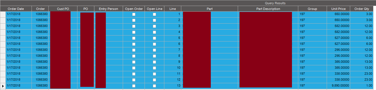

I have been tasked with making a report that shows certain sales orders linked with their purchase orders. We don’t have Buy to Order, but instead a custom field in the Purchase Order entry that the entry person puts the SO # in to link the two together. If by template you mean what the ideal results look like, it would be this:

As you see the LINE number is different and that is why it looks like multiples. What would you like to see instead? Joining to another table will not remove duplicates if you have that line number in there as that field is not a duplicate on any of the above in the image. I see no duplicate data… If you wanted you could create a Report with the PO Num, SUM Qty on each Part @ Price to reduce only if you either remove the line numbers or turn them into an aggregate. You need to decide what you are really after but there is no duplication above that I see as the LINE is different on each ROW.

Still will not remove anything if he is listing EACH ROW’s LINE COLUMN… Look @ image.

Yes, if he were utilizing the PORel table and had multiple releases and the join was not defined properly he might end up with duplicated lines in that scenario, but from his image that did not look like that was in his dataset.
Apologies, John, @kananga, he does say that would be the ideal and yes he will need to decide how to aggregate his PORel data as that will generate a ROW of data for each release even though he may only want one line of data per ORDER LINE this is unclear in his image.
@mlp what LINE are you looking for? PORel line or Order line?
You can subset the data with a subquery against PORel to only generate ONE PORel LineNum per OrderNum by using the PORel as primary like John listed. I did not look at/load the BAQ to verify what your original query looked like, but John looks to be defining the best starting join for you.
Hello. Sorry for the delay.
The screenshot I showed was what I wanted. What was happing is those were turning into 169 lines. So the lines were multiplying themselves.
