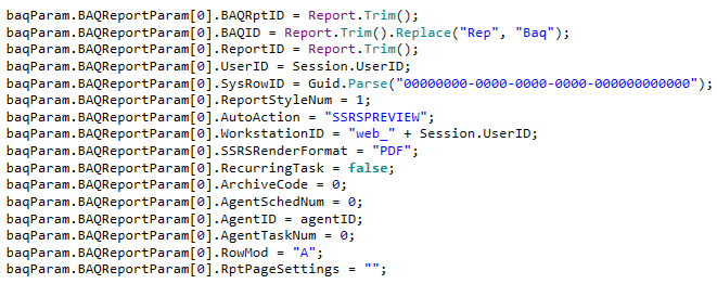

If you are on hosted servers, it could be the “WorkstationID” failing this out.
When I built a function for printing some production labels, the workstation had to be set to “web_” + The current user’s ID.
