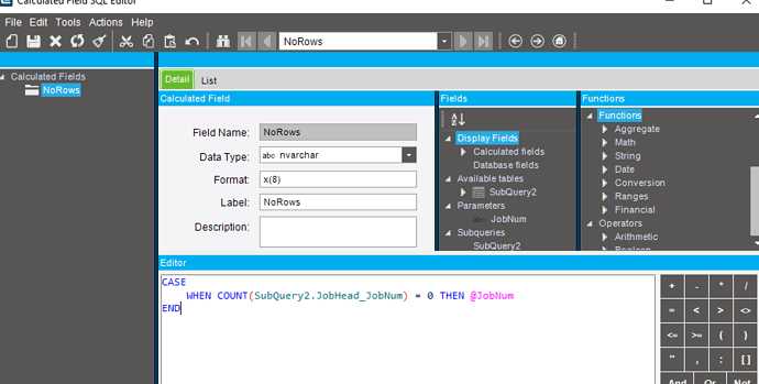

Fernando,

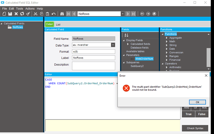

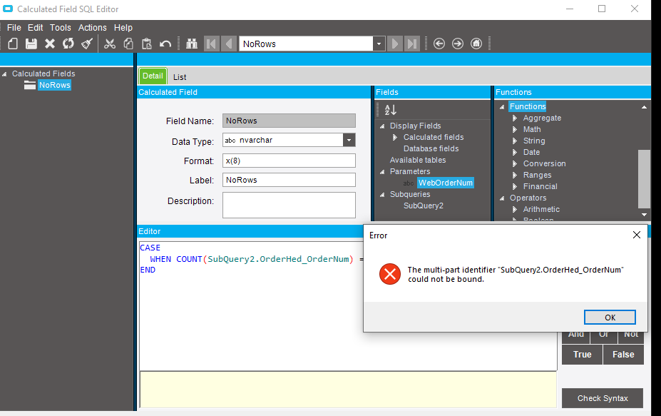

This sounds like exactly what I need. Unfortunately, when I try to create it I get the error below:
Clearly I am missing something.
My subquery2 is one table, Erp.OrderHed with one display field OrderHed_OrderNum. The criteria is ECCOrderNum=@WebOrderNum
With @WebOrderNum as a required parameter.
Any thoughts?

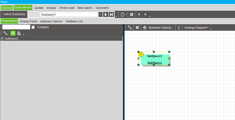

In your screenshot, I don’t see “Subquery2” as an available table. You may need to bring it in the query builder tab.

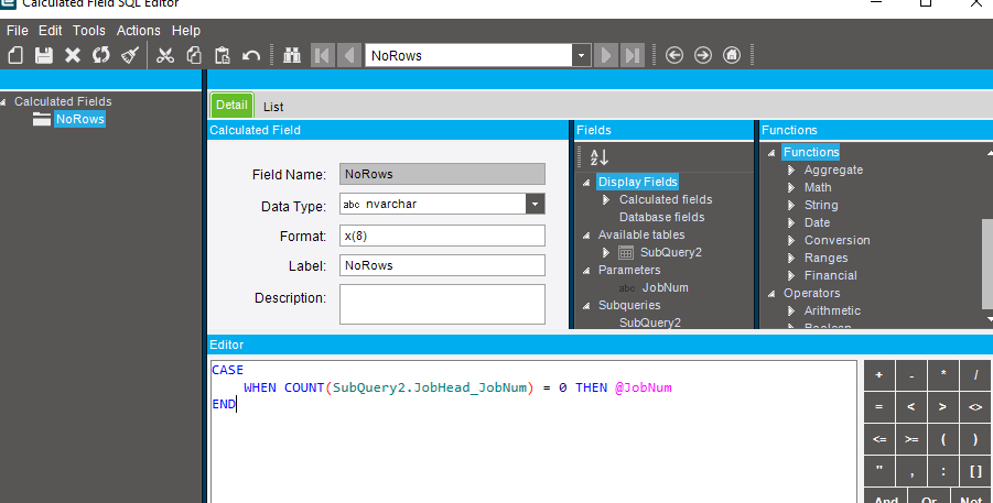

Also, I should have mentioned but I didnt know what you were trying to return, in that case statement you should return the OrderNum if the rows are greater than 0 because as it sits, you’ll only ever get results when the rows returns are 0. Unless that’s what you’re going for.
Something like this.
CASE
WHEN COUNT(SubQuery2.OrderHed_OrderNum) = 0 THEN @WebOrderNum
ELSE SubQuery2.OrderHed_OrderNum
END
Edit, just thought if you do add the “else” part of the statement it will probably will expect SubQuery2.OrderHed_OrderNum to be a display field on the top level which will mess with some things.

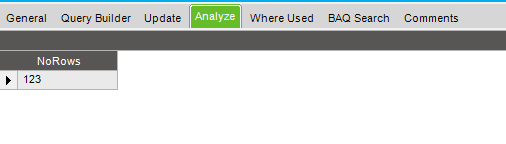

Thanks Fernanado, you solved my problem! Actually, returning nothing is what I am looking for in this case. I am using this with the REST services to see if a web order already exists and I need it to return the parameter I pass if it is not a duplicate. I clearly need to brush up on sub-queries in BAQ.
