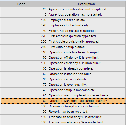

There is probably a shop warning for what you want. No need to reinvent the wheel:
