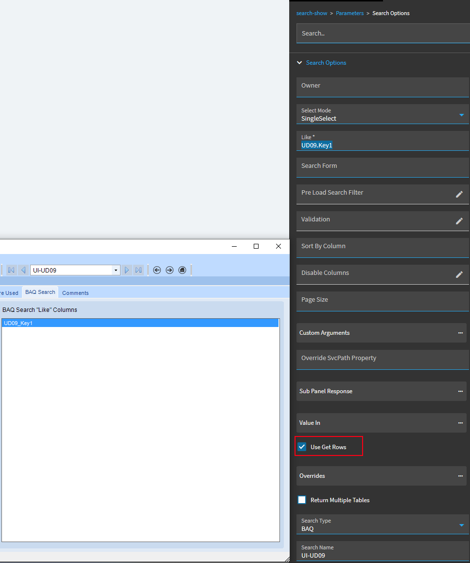

As a background, you can set up a search-show for a BAQ that refers to the Like criteria you have specified in your BAQ’s BAQ Search column selection.
The search-show default search options are to have “use get rows” unchecked, and in previous versions this has not been required. However, in 2025.1.5 when you try to apply your search-value-set you will see network GetLists that are retrieving data related to your selected record without the search dialog dismissing. The fix is you need to check the Use Get Rows now. This may or may not be true for all BAQ searches or just those that use UD field keys as the Like field, but I figured I would post the simple solution here for everyone else going through it this week. I use this functionality a lot, so suddenly a lot of my BAQ searches broke with the upgrade until I found this fix.

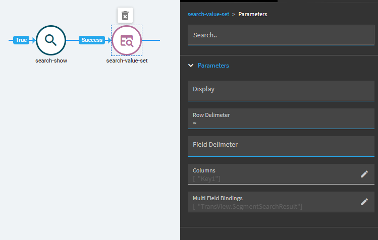

As of 2026.100.5 (15.0.55-hotfix.4), this functionality has changed again. Now, GetRows ignores your search selection and returns all data in your search as a tilde-delimited list. Unchecking GetRows no longer has the bug introduced near 2025.1.5 and does honor the selection correctly. Search-value-set was adjusted as shown here, but it may not matter.
