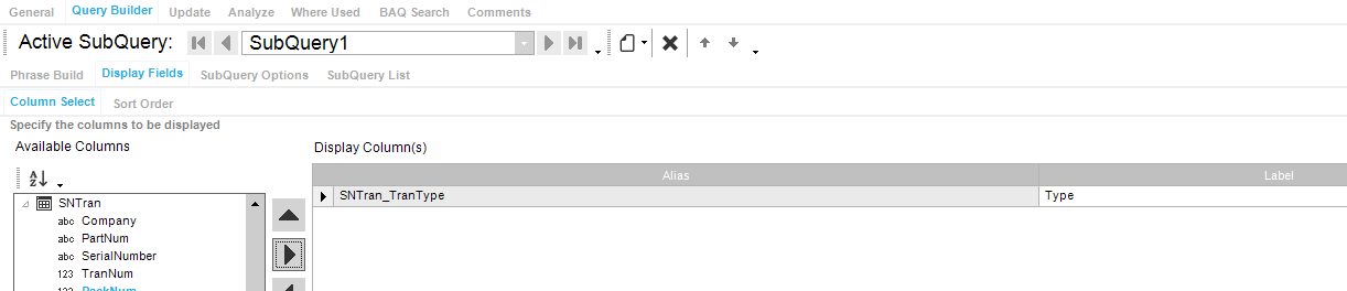

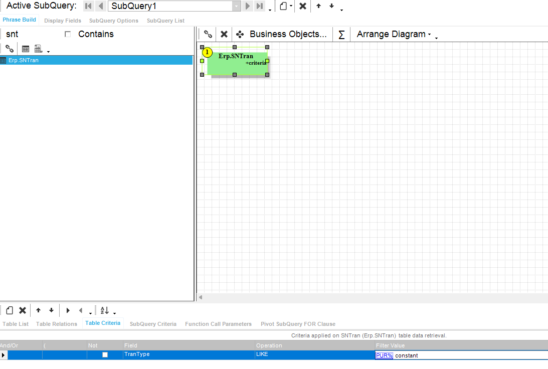

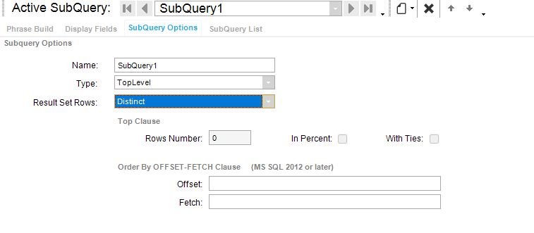

These are all the potential ‘PUR-’ transaction types
Do you have any of these in SNTran?
from this list in the BAQ there is PUR-INS,PUR-SUB is there another place i can check to make sure?
Create a BAQ on SNTran , add a criteria of like ‘PUR%’ and select distinct rows in your sub query options
