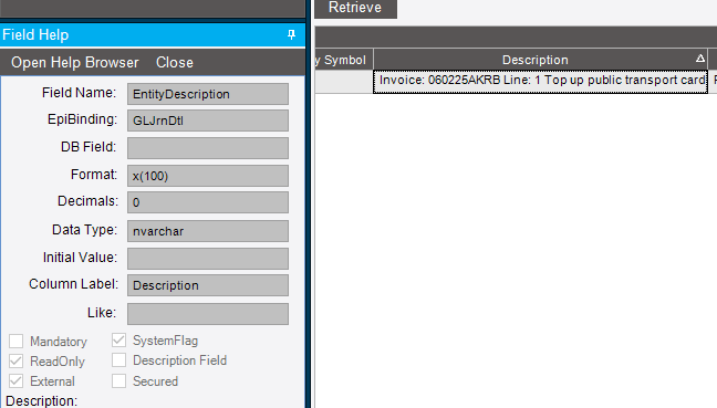

Really looking for a way to add/replicate the Entity Description field under Chart Tracker → Transaction Detail in the Specific Transaction Detail grid. Mostly because the AP Header detail posted to GL is too coarse for the accountants and they would like to see the underlying AP invoice line details.
Amending posting rules to change posted text is relatively easy but it does add significantly more text which is unnecessary in the GL.
