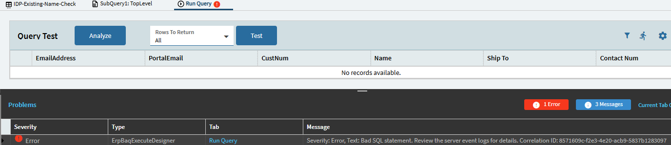

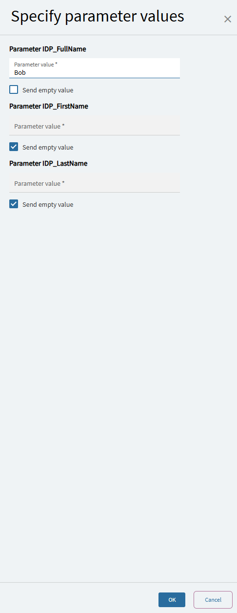

However, when I run the query with @IDP_FirstName and @IDP_LastName empty, I get a “Bad SQL statement” error instead of the condition being skipped.

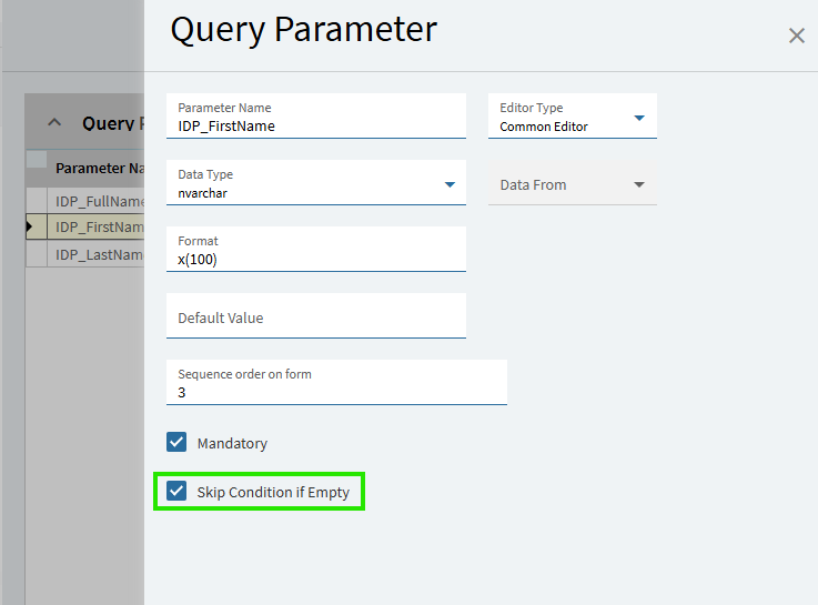

I have Skip Condition If Empty checked for @IDP_FirstName and @IDP_LastName (see screenshot), but it doesn’t seem to work as expected.

Only thing that jumps out…both Mandatory and Skip Condition If Empty are checked…if it’s a mandatory entry then it can’t be empty.
I think it only skips the simple condition, like value=@parametername

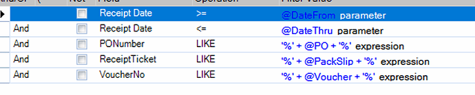

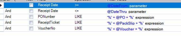

I think what I did last week in Classic could work for this. I was hitting the same bad sql issue and went with using the parameters with like in an expression, so if it is empty it is like ‘%%’ and not skipped but always true.
