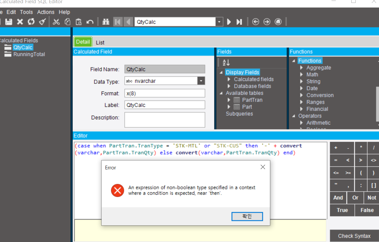

I want to make a field that displays “-number” for TranTypes that are deducted from stock. When I first put only “STK-MTL” it worked fine. However, when adding “STK-CUS”, the following error message appears.
Please help on this issue. thank you.
Try changing:
PartTran.TranType = 'STK-MTL' or "STK-CUS"
to
PartTran.TranType IN ('STK-MTL', 'STK-CUS')
You could also do:
PartTran.TranType = 'STK-MTL' or PartTran.TranType = 'STK-CUS'
case when PartTran.TranType in (‘STK-MTL’,‘STK-CUS’) then ‘-’ + convert(varchar, PartTran.TranQty)
else
end
Thank you so much. This issue has been resolved well.
