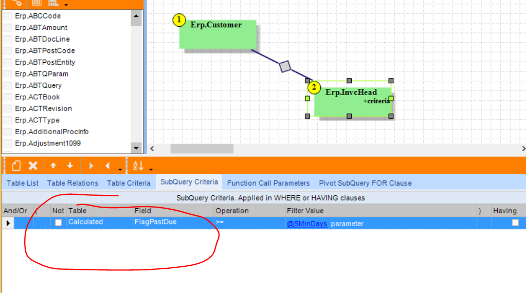

BAQ SubQuery to Sum Total based on parameter calculated field
I am having a tough time trying to get what I thought was a simple task
Show a list of Customers, one line per customer, with a balance total of Past Due invoices; “Past Due” being based on a runtime parameter “DaysPastDue”
So the user enters the past due days - like 360. and each customer is shown with the invoice balance which is greater than 360days past due.
No matter how i setup the toplevel and subqueries - i get multiple lines per customer.
I’ve tried subquery/pivots - nothing seems to avoid multiple lines generated from the subquery which determines IF an invoice is past due - and sums the total.
Looking for any examples to try… TIA

i think i tried that already and it was unsuccessful
(1) the date math needs to be based on the invoice date - and provide a value FROM the invoice date, not the current date
and
(2) when i do that i must include the calculated field in the summary - and that’s when the stuff hits the fan…
Which is why i tried various subquery options…
thank you :slight_smile:

So your version DOES provide a single line result - but it doiesn’t provide the proper selection. And getting that selection is what throws a wrench in the resultset
i dont know how to get the selection without a calculated field

that is the issue - i dont think i can do this - or havent found a way
and yes, we’re looking for the total balance for items which are XXX number of days past their invoice date. So it varies on each invoice.
Since I have to group on the calculated field to meet syntax
I thought maybe the subquery was returning values for each datediff
that is why, i was using a binary flag to determine (past due) selection.
and then filtering subq on TRUE value or PIVOTing on the binary value and using only the True value field.
