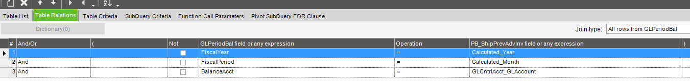

Can you show the join between the top level and the subquery?
Also, try outer join if you aren’t already.

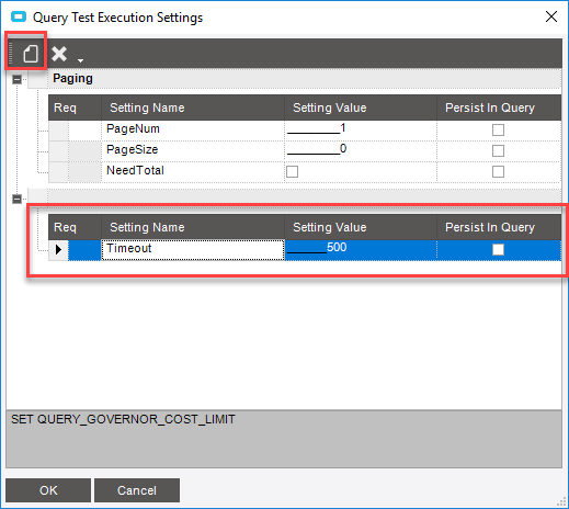

You can adjust the BAQ timeout as well. We have one that’s well designed it’s just needing to pull a bunch of data from the GL so times out until we changed the timeout.

@Banderson I did not bring company in the join on every table. We only have 1 company so I miss it sometimes. I will try to go add it on all the joins and see if it helps.
@Craig_Moore here is the join on the top level and the sub-query. As I said, the join works when I only display the year and month fields.

How do you adjust the timeout?
<div class="post-metadata">
**Author:** ![Randy](https://www.epiusers.help/user_avatar/www.epiusers.help/randy/32/51539_2.png) [@Randy](https://www.epiusers.help/u/Randy)\
**Post date:** [February 25, 2019, 2:18pm UTC](https://www.epiusers.help/t/baq-timeout-why/52656/10 "2019-02-25T14:18:13Z")
</div>
In the BAQ designer under Actions - Execution Settings. You’ll need to click on the new icon then use the pulldown under Setting Name. NOTE: Use caution adjusting setting in here and always test on a non-production server.

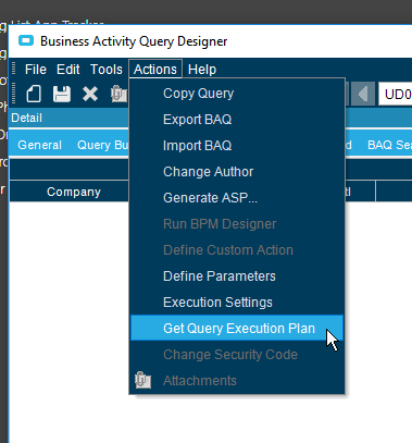

If the query cannot be changed anymore (like adding all of the indexed fields you can), getting the SQL execution plan and opening it up in the a sql editor will give you a suggestion to add an index to the database. The thread that I linked below is one that I did that too and increased the performance immensely. Keep in mind, you don’t want to go crazy on adding indexes to the database, but if you have something you _really_ need, it can make a query that’s unusable, usable.
![image](https://www.epiusers.help/uploads/default/original/2X/c/c2103f384ebce47cb3eb05c530ee5418a41a3ebd.png)
> **[Unions and performance](https://www.epiusers.help/t/unions-and-performance/44009/35)**
> In case anyone is wondering, these are the things that I did to improve performance on this BAQ. I added the JobHead table to my sub-queries that had any epicor tables in it. I didn’t use any of the fields, but it seems to have helped. That was...
