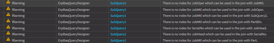

I also noticed when analyzing the baq i get the following errors
Any clue on how to fix this?
Check your joins for the tables referenced. Looks like they aren’t set to use an index which will improve BAQ performance.

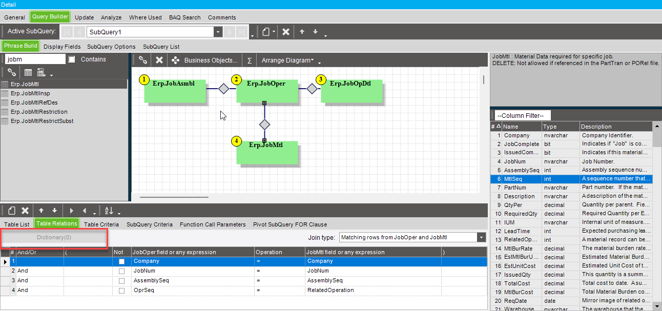

As for the indexes, could this be done in epicor(BAQ designer)?

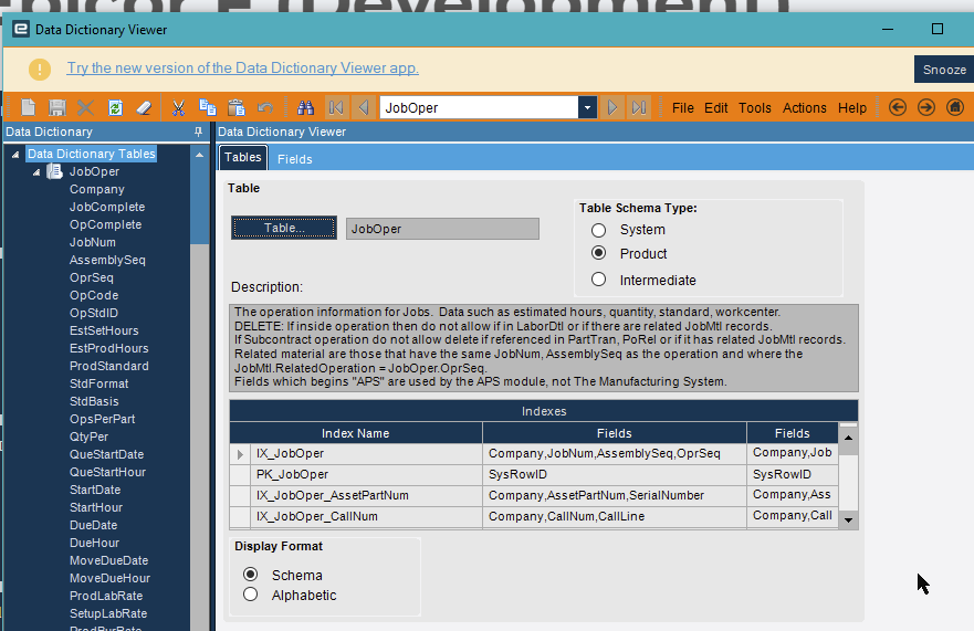

Yes for joins if there is existing indexes it’d be under the Dictionary button. However there isn’t one between JobOper and JobMtl but the relations I’d suggest are what I have here on Company, JobNum, Assemblyseq, and OprSeq - RelatedOperation.

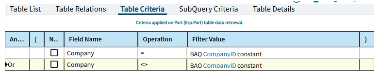

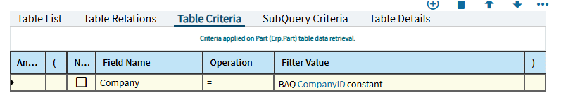

In these situations (it was super quick, then I changed one thing and now it takes hundreds of seconds), I think I have found 100% of the time that just slapping a company criteria on a table will jolt it back into obedience.
Like so:
Or if there’s a subquery, maybe do this there, too. I don’t think it would ever hurt.
Well, unless you need it to be cross-company. Eek, I don’t know what I’d do without this trick.
Maybe this:

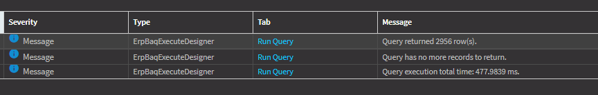

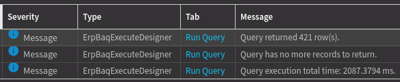

That might not a BAQ timeout then? Maybe the SSRS is doing something intensive and times out? Or it’s some other server side issue triggering a different timeout? How long does the SQL take to run in BAQ? Not by your perceived time - the execution time returned in the “problems” window.
Also, I tried the table criteria recommend by JasonMcD, and it worked using pdf out.
That’s not an index, that’s just a pre-programmed dictionary to make BAQ’s easier
The see indexes that are present you look in the data dictionary.
Basically, if you can use all of the fields in one of those indexes in your join, you should. For example, use Company even if you’re only one company. This will help the system use the index and help the query run faster.
Yes, you’re correct. It’s not the actual indexes of the tables.

When testing the BAQ(BAQ Designer) it runs fine despite the index errors

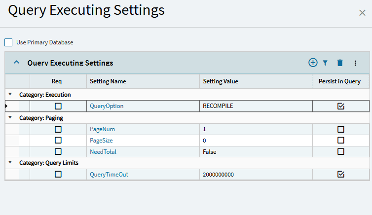

Have you tried adding in the recompile option? It can help some BAQs and has been referenced in multiple threads here on EpiUsers I’ve linked one below.
No luck with the recompile option.
These are the settings in place
