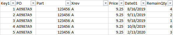

I have a table (UD03) that contains a customer’s requested release information. Here is an example:

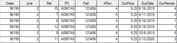

I also have a set of order releases in Epicor that match this list of requests. For example:
If you study the rows for a bit you will see that we have one extra release in Epicor, compared to the list of requested orders from the customer.
This is where my problem comes in. I would like to have a query that lists all of the releases in our system that do not match a request from the customer’s file. In the end we will close, delete or update these releases so that our open releases matches the customer’s requested releases.
The problem I have is that since the date and quantity match an existing requested order, my BAQ is not flagging the extra order in our system. I need a way to match one of our releases to a single customer request, then remove that request from the list of available requests so that if the BAQ comes up to a second release in Epicor (that would have matched a customer request) then the BAQ will show me the second release indicating that it can be closed/deleted/updated, because the other requested release that matches has already been accounted for.

You could try assigning a rank/row_number to both tables based on your matching criteria, so rows that have the same matching criteria will also have a UID. Then you could use that to determine if you have extra releases.

I like the sounds of this. I will look into ranking/numbering the rows and see if I can get that to work.
