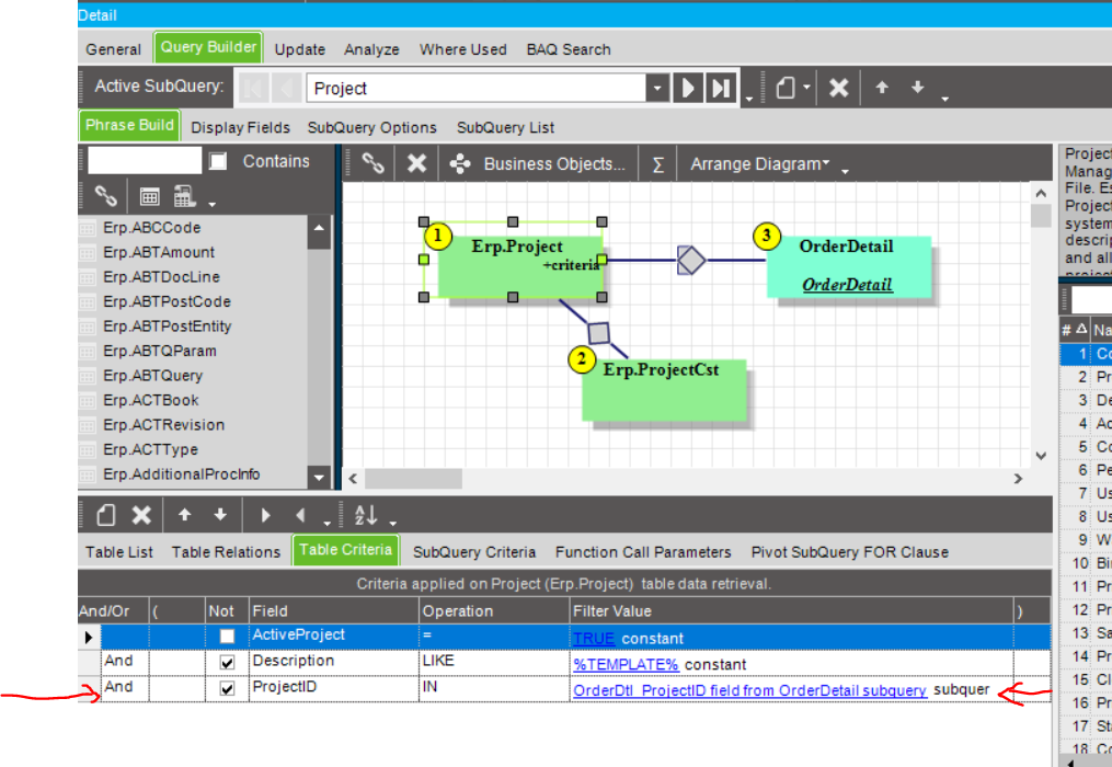

You can alse create a top level query with the Project table, and a subquery with order detail and project ID displayed. Then in the top level at a criteria to the Project table on Project ID with a NOT IN subquery.ProjectID criteria.
