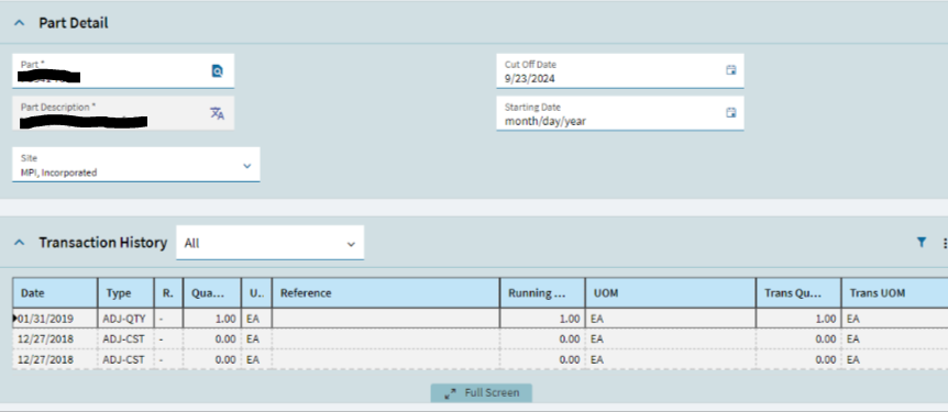

BAQ to return PartNum(s) that only have TranClass "A" or TranClass "X" in their transaction history?
We are trying to identify parts that have only TranClass “A” or TranClass “X” transactions in their Part Tran table. Here is an example of one part like that:
Everything I’ve tried still pulls in parts that have other TranClass types in the transaction history. Any suggestions on how to get a list of parts that only have TranClass “A” or “X” in the PartTran table?

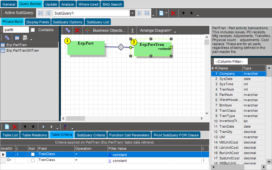

I would expect this should work for you:
Also I mean it should work in as a starter, you’d likely want a subquery that is grouped by partnum and returns company and partnum. At least that is likely where I would start and see what kind of performance is returned.

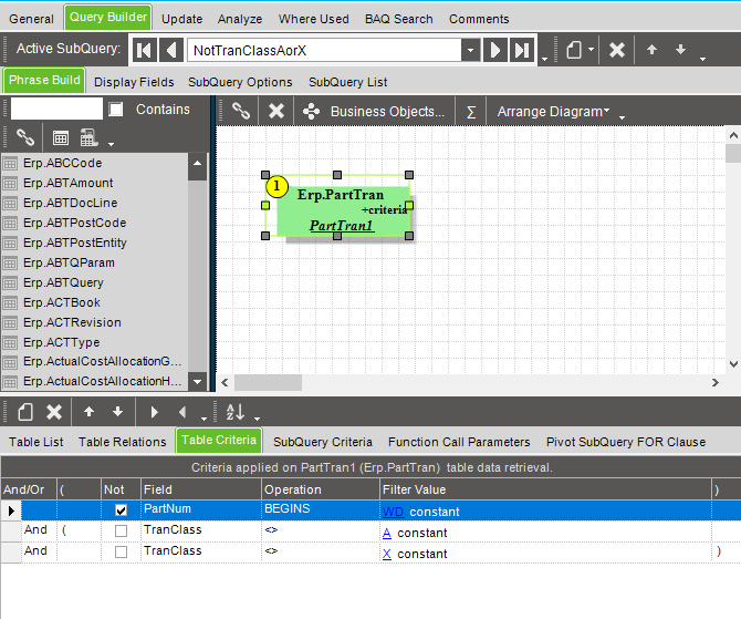

inner join (select
[PartTran1].[Company] as [PartTran1_Company],
[PartTran1].[PartNum] as [PartTran1_PartNum]
from Erp.PartTran as PartTran1
where (not PartTran1.PartNum like ‘WD%’ and (PartTran1.TranClass <> ‘A’ and PartTran1.TranClass <> ‘X’ ))
group by [PartTran1].[Company],
[PartTran1].[PartNum]) as NotTranClassAorX on
Part.Company = NotTranClassAorX.PartTran1_Company
and Part.PartNum = NotTranClassAorX.PartTran1_PartNum

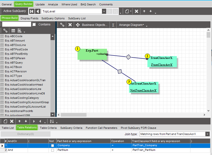

Are both subqueries pointing back to Part? Can you drop a screenshot of your BAQ diagram?
Both subqueries are joined by Company & PartNum. Both subqueries only have the Company and PartNum fields as Display Fields and both are flagged Group By.

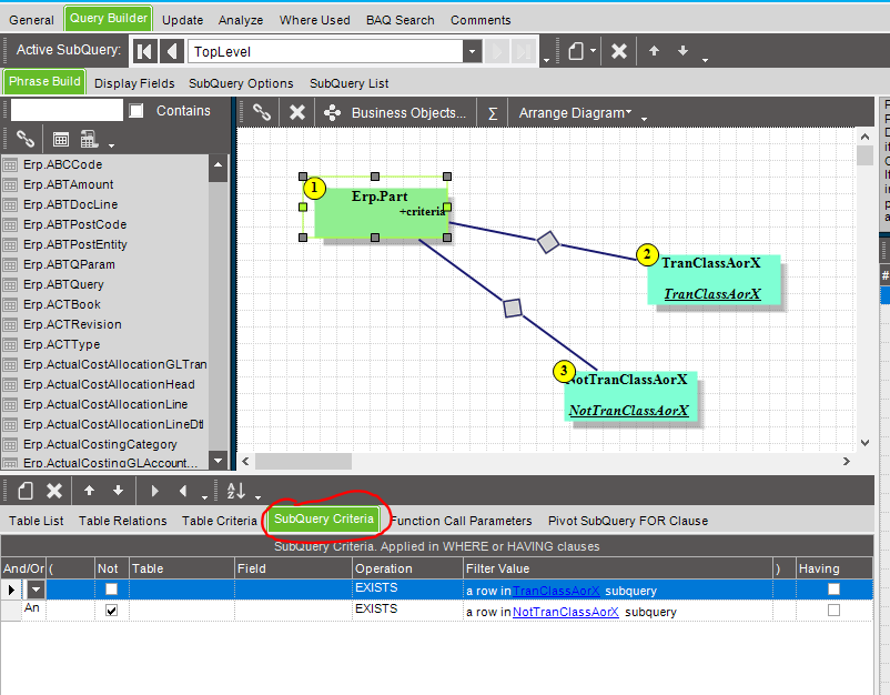

Try this one - I’m getting output on our side
BAQForExport_PartTran_AXOnly.baq (40.1 KB)
Hi John,
The BAQ you whipped up appears to be working like a charm! I see that instead of putting table criteria on the subqueries you used SubQuery Criteria. And you used a calculated field to filter it all for the result I was looking for. Awesome! Thank you again for all your help on this! So many years doing this and I still learn new things everyday.
