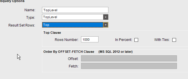

Run wide open, this obviously hits the 1000 rows max, so to check it, I add a temporary table filter and I get 44 rows, which is right. I take that out, because I’m going to put it into a dashboard with a tracker in it to filter it.
We I get to the dashbaord, I add my query, add my trackers, like normal. But I only get back 14 rows!! what the heck? If I add a criteria back in the BAQ for only open lines, it returns all 44. Take it out, back to 44. If I order my query by PO, I get no rows.
