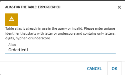

BAQ using table aliases with a dash - how to address in a calculated field?
Typically I would think when using aliases/names that have special characters, you would escape with brackets: []
But in doing that, calculated fields don’t seem to respect the []
my calculated field is this:
KitToFG.PartMtl-Kit_MtlPartNum or SubQuery.TableAlias_Field generically
i tried to escape with [KitToFG.PartMtl-Kit_MtlPartNum], am i missing some funky syntax? :slight_smile:

Got it!!
This syntax works after all, just required me reloading the BAQ designer several times:
[PartMtl-Kit].[QtyPer]
1.) Sure, but this is a query already written with dashes all over the various subqueries it consists of, so understanding how to utilize the dash in an alias would be the path of least resistance to modification. Also, Epicor states you can use a dash (even though it goes against SQL best practice dating back to forever) - so I wanna know how! :wink:
