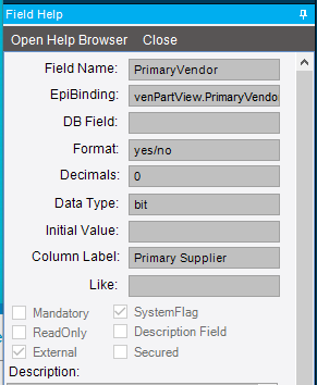

Hello Everyone - I am trying to create a BAQ that shows the primary supplier based on the price list.
I am using the table Vendpart. Primary Supplier is NOT a field. I have searched other tables and cannot find this field from the price list.
Please see attached.BAQ missing fields Vendpart.docx (180.3 KB)

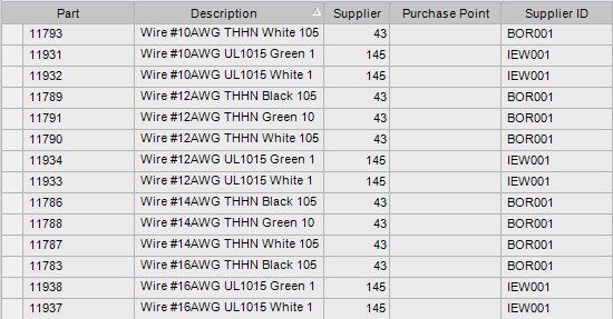

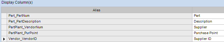

The Vendor Num/Pur Point on the part plant table is the one that will be checked as primary.
Primary Supplier is listed under Vendor.VendorID when its linked as shown.
