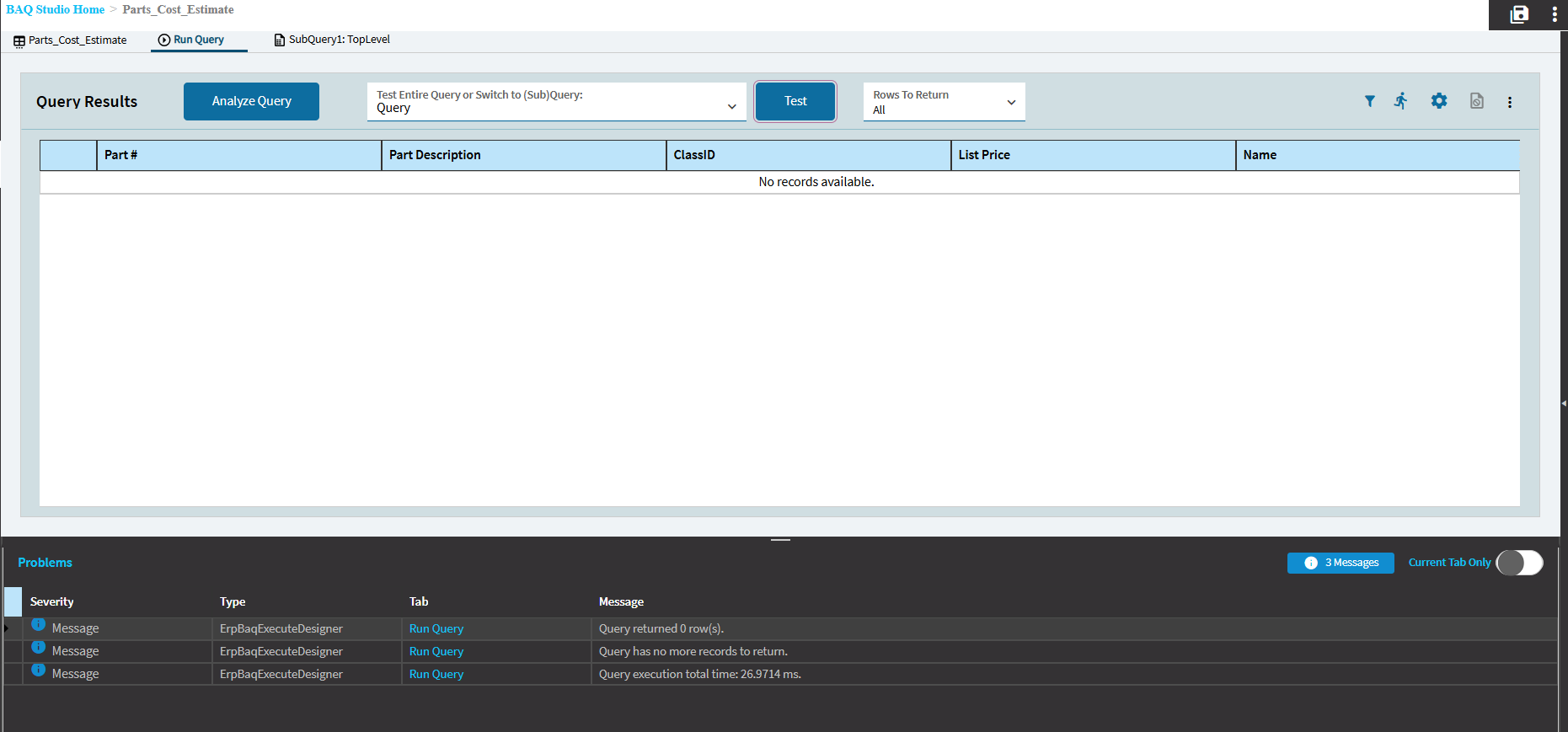

I am currently having an issue with a BAQ, we are currently implementing Epicor and I created a BAQ that was working and returning all data, and we had to do a refresh and not it returns 0 rows but syntax is okay.
Does anybody know how to fix it? I don’t want to create the BAQ again.

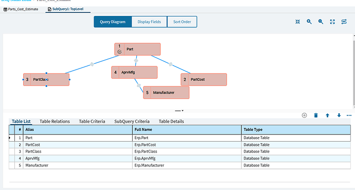

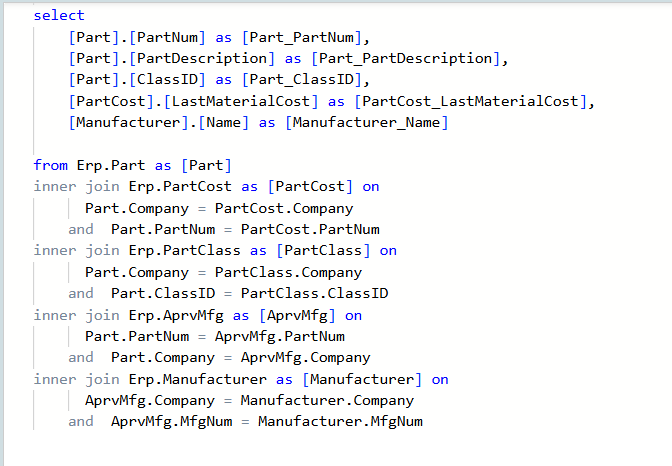

So, you have a lot of inner joins there (the :diamonds: join).
Your BAQ is saying, “Only give me parts that have an approved manufacturer AND a part class.” (Both true, not either/or.) Is that what you want?
Also, what is the criteria on the Part table?

Thanks for your response, I was out for a couple weeks. I did figure out what was going on, I was trying to get the Qualified Manufacturer, but that information did not come over after the refresh, so after uploading those, it worked.
