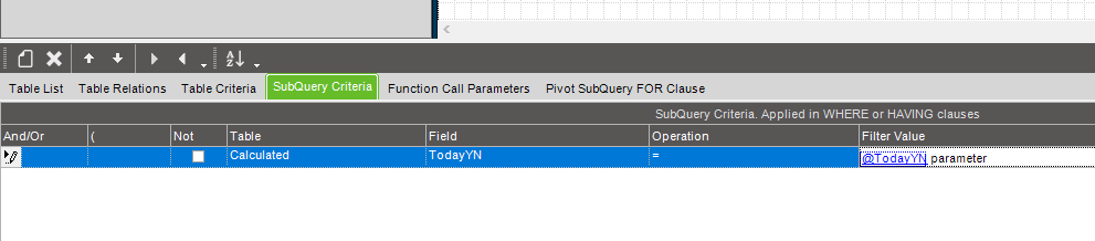

Can anyone help me? I need to filter “OrderDate” in Sales Order by the last 7 days and “today”.
It will be two seperate BAQs one with last 7 days and one with today… I don’t know how to filter it. I just keep getting orders from 15 years ago…
Aaron.
aclements
(Andrew Clements)
2
Hi Aaron,
Firstly a criteria on the OrderHed table where orderdate >= last 7 days
Then I’d create a calculated column returning Y for today’s orders
You can then create a subquery criteria against the calculayed column
Cheers,
Andrew.

Hi Andrew,
That worked perfectly, thank you.
