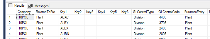

The “RelatedToFile” probably needs to be “PartPlant”, which is the name of the table in SQL.

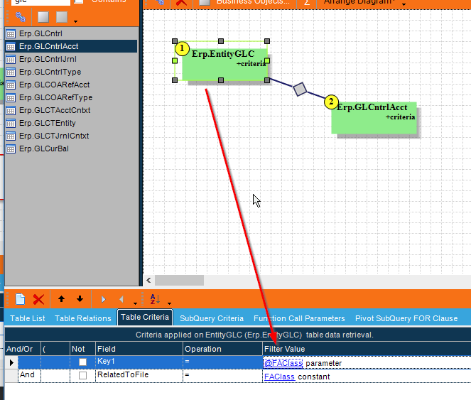

This is what I get.

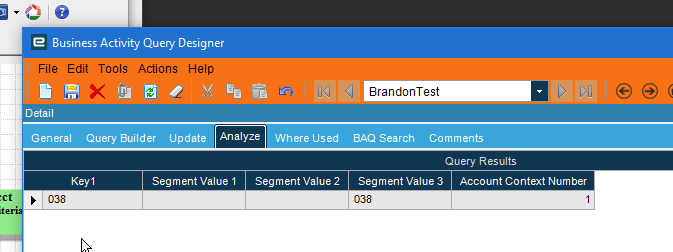

And it’s working for me.

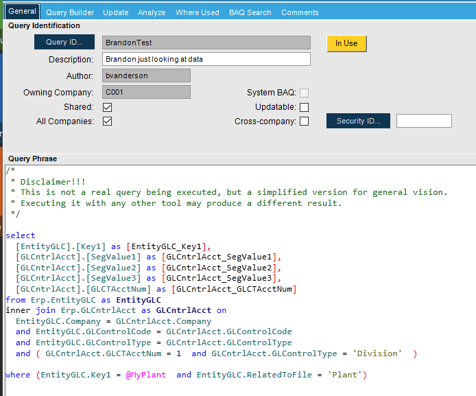

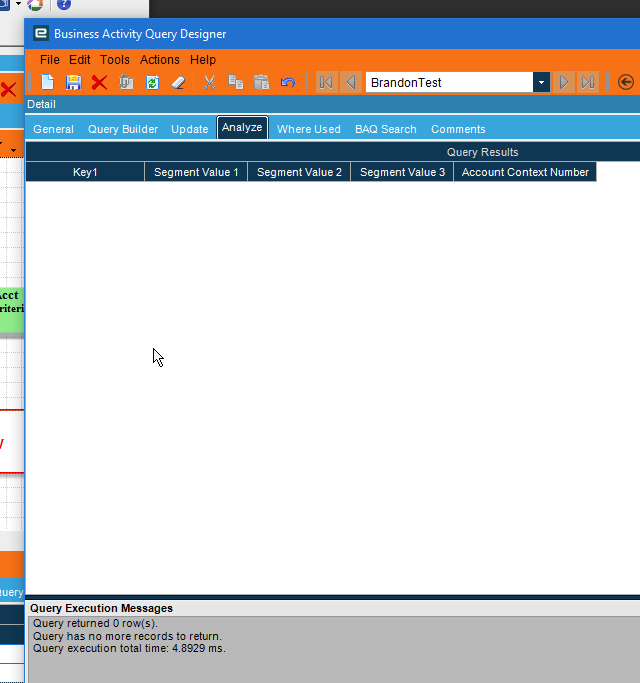

AND if I change the parameter to @Plant
it breaks.
It looks like the constant value and the parameter name being the same thing trips it up. I chose a different class, name the parameter that class name even though I used it tied to plant, and it derped out.
Also breaks

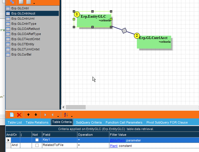

Extending on the issue:
  • If you switch the parameter and constant positions it’s still borked.
  • If you change the AND to OR it’s still borked no matter what the values are, as long as the constant value == the parameter name.
  • If you add another parameter with a name different from the value in your WHERE constant it’s still borked even if you never use the colliding parameter. Interesting!
  • If you drop the colliding parameter and feed the same value to both the parameter and constant condition, all is fine.
  • If you change your WHERE constant to a string in an expression everything seems like it’s fine, although I only spent a minute or two poking at it.
Seems like this might be constrained to the constant option. Maybe it’s being parameterized in code on its way to SQL text, naively using the constant value as a reference?
