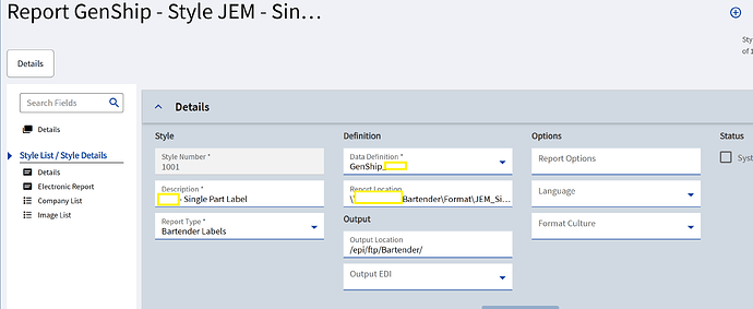

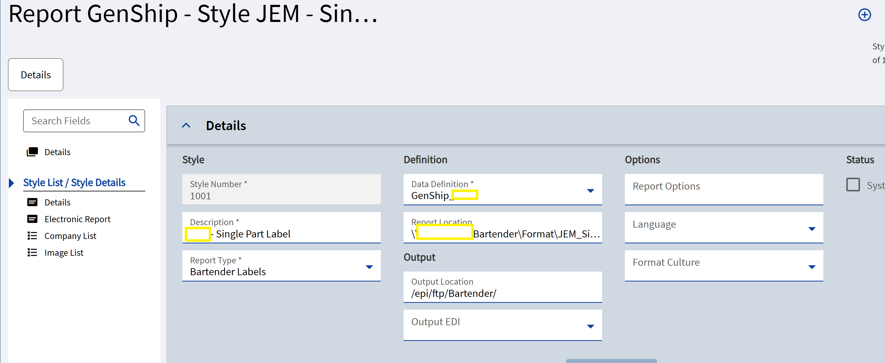

After the 2026.100.7 upgrade our Bartender FTP Output path changed from a UNC to a specific prefix.
The new path is /epi/ftp/Bartender

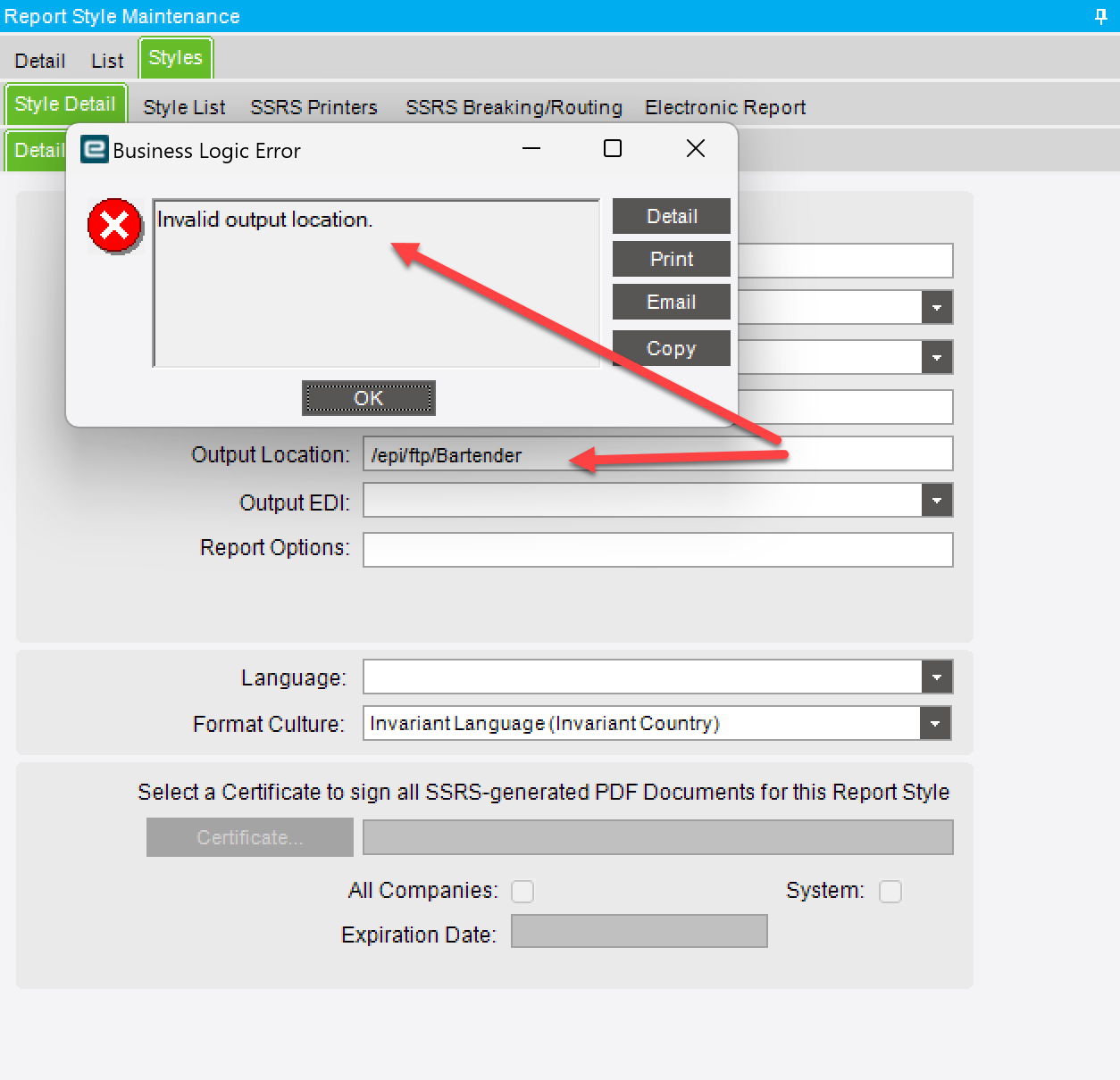

We are unable to save any output location value other than “/epi/ftp” or “/epi/fs” (we are using FTP). If any other value, including “/epi/ftp/Bartender” (even with an extra slash at the end), is entered, an error is produced “Invalid Output Location”. This occurs in both Kinetic and Classic screens (we are deferring 2026 update until October).
When we try to export to our regular FTP location, which would be “/epi/ftp”, the task errors with “Access is denied” permissions error. We’ve opened an Epicare ticket for the issue but no help yet since the problem occurred after the weekend update. Our label printing is still down. I will update if we find a solution.

I don’t use FileZilla for that reason-- I use WinSCP. And yes, I have created multiple folders and tried each. Same error: Invalid Output Path. If I use the root “/epi/ftp” (we used to just use the root folder before the linux update), the task errors with “Access Is Denied”. Hoping it’s simply a permissions debacle which can be resolved by Epicor. Awaiting an update from Support.
