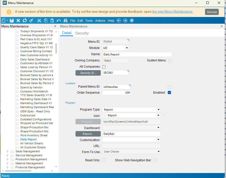

Its pretty easy. If you are worried about messing anything up, do it in the pilot first.
Here is an example menu item for a specific report:
The security ID and parent menu will depend on how your company does stuff. I would look at a menu item that already has the security you want and copy that.

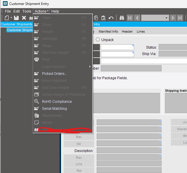

To make myself clear, they wanted to add it to the Customer Shipment Entry screen pictured in screenshot below where the red line is.
I am unsure on how to add an item here.
I am unsure on how to point it to a print dialog that uses the report I created.
If you need more information, just let me know and I will provide it.

I’m not sure about the parameters on that ProcessCaller.LaunchForm() method. The ā€œOutRptā€ string might be the menu ID of the report, shown in Menu Maintenance?
Yes.
