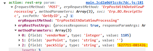

What it passes when I preview changes in App Studio (which is the new value my event is creating):

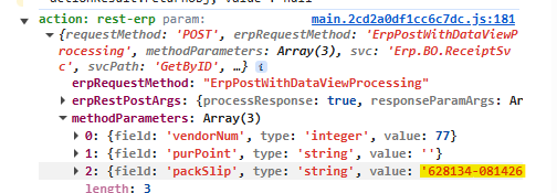

vs. what it passes after I’ve published the layer (the pack slip that exists in the record):
Why are these different?!? What’s different between Preview mode and when published??? :grimacing::grimacing::grimacing::grimacing::grimacing:
