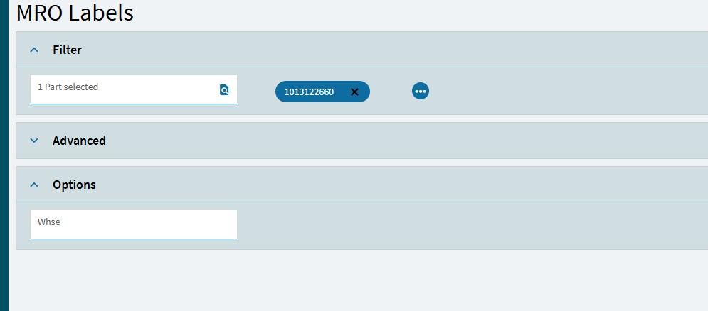

Hi All, I have a small but big issue. We have a few BAQ reports that our users like to run. Right now they have to click the search icon, then go through and select the parts that they want to run the report with. They would rather just type the Job Number or Part Number in to the BAQ Report and hit tab and it would then add it to the “queue” to be able to run the report on. Picture for reference. I know i have to add an event most likely on blur but just wanted to see what the best practice for this was.

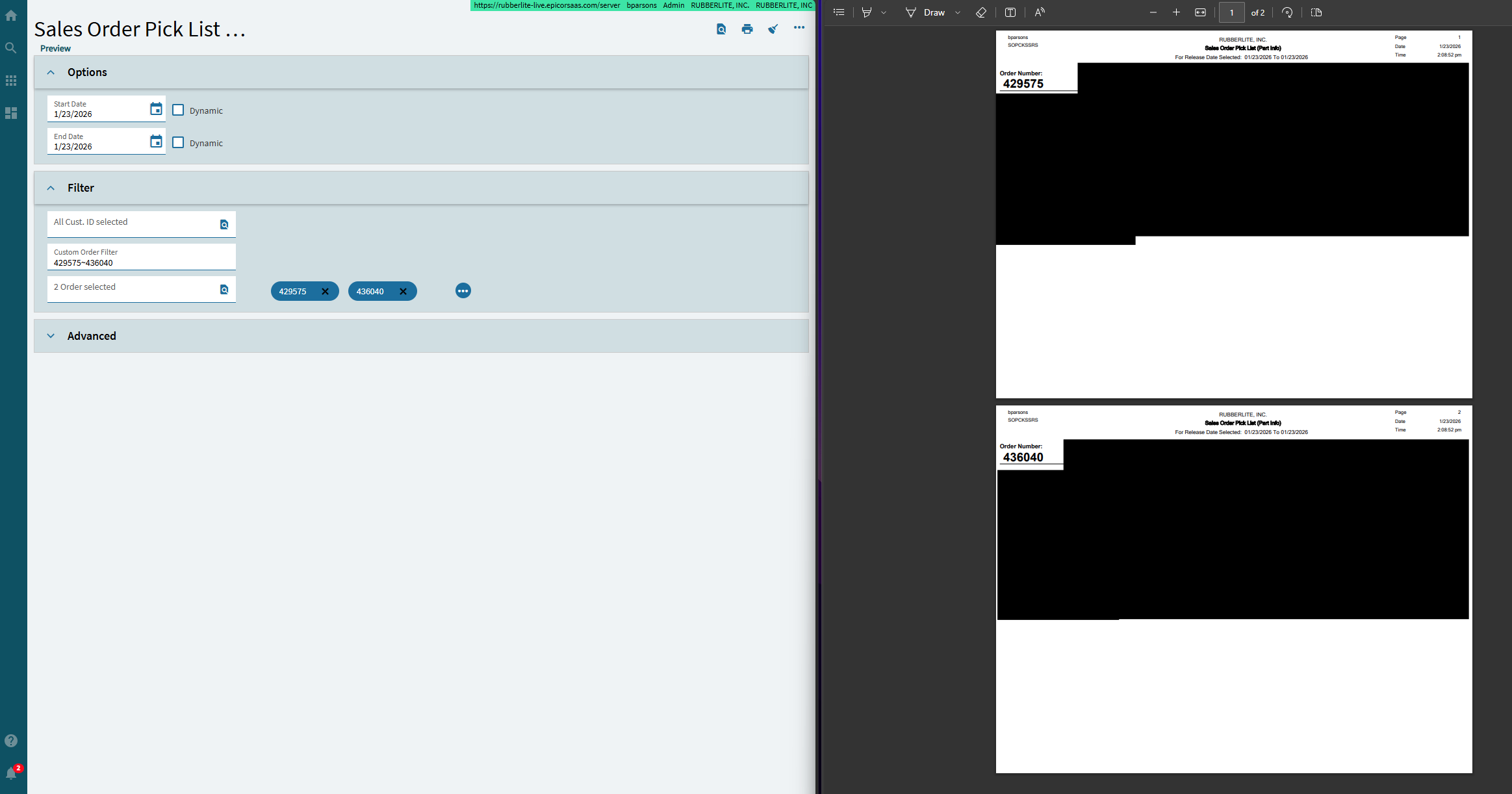

Please submit to EpicCare and raise hell. We also have this issue. Our case is CS0005241267 and has been associated with PRB0282558, originally created in May of 2024 with no resolution date. Recently switched our users from Classic to Kinetic (and removed access to Classic). Printing reports with multiple Sales Orders is a PIA. EDIT: For us, all BAQ Reports have this issue.

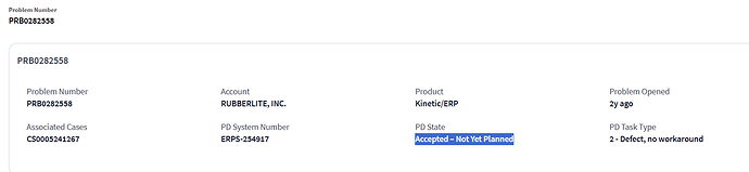

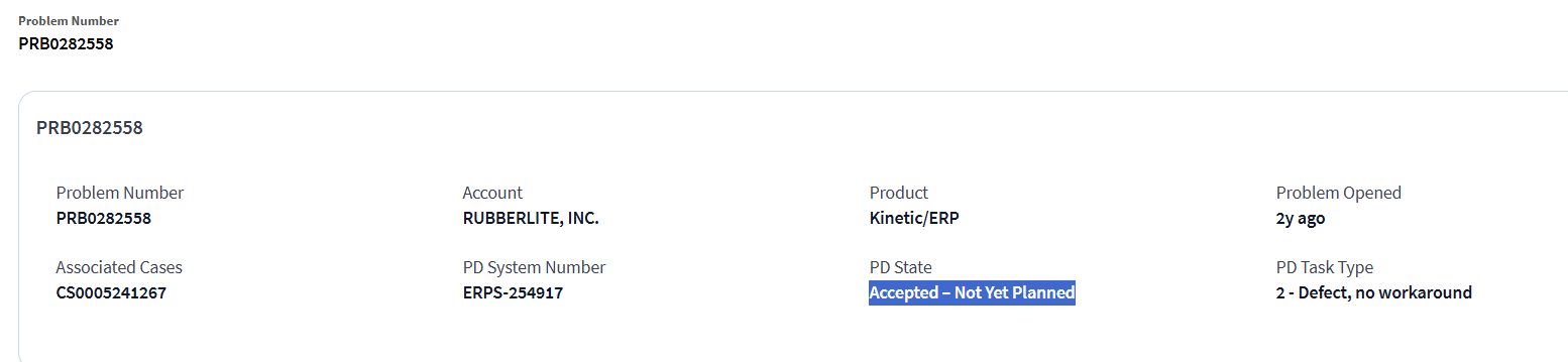

EpicCare shows Accepted - Not Yet Planned for PRB
But hey its at least p2 so there is a tiny chance it might get fixed before 2030.

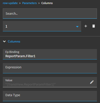

Bind it to TransView.ReportParamFilter1 (or anything you want really).
Create an onBlur event of that new textbox which sets ReportParam.Filter1 to the value of TransView.ReportParamFilter1.

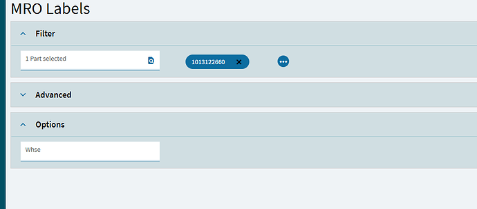

Preview:
… the report generates, but the problem I’m having is that I’m only getting the report (label) for the first value being passed. BUT, this could be a bug in my BAQ report. Even if I use the stock chip-selector and choose multiple parts, only the first one actually prints.

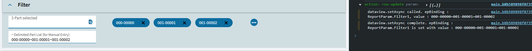

Then it should work as it should: type + enter, multi paste, and multi select search.
like this:
Thank you Josh! This worked out great!
