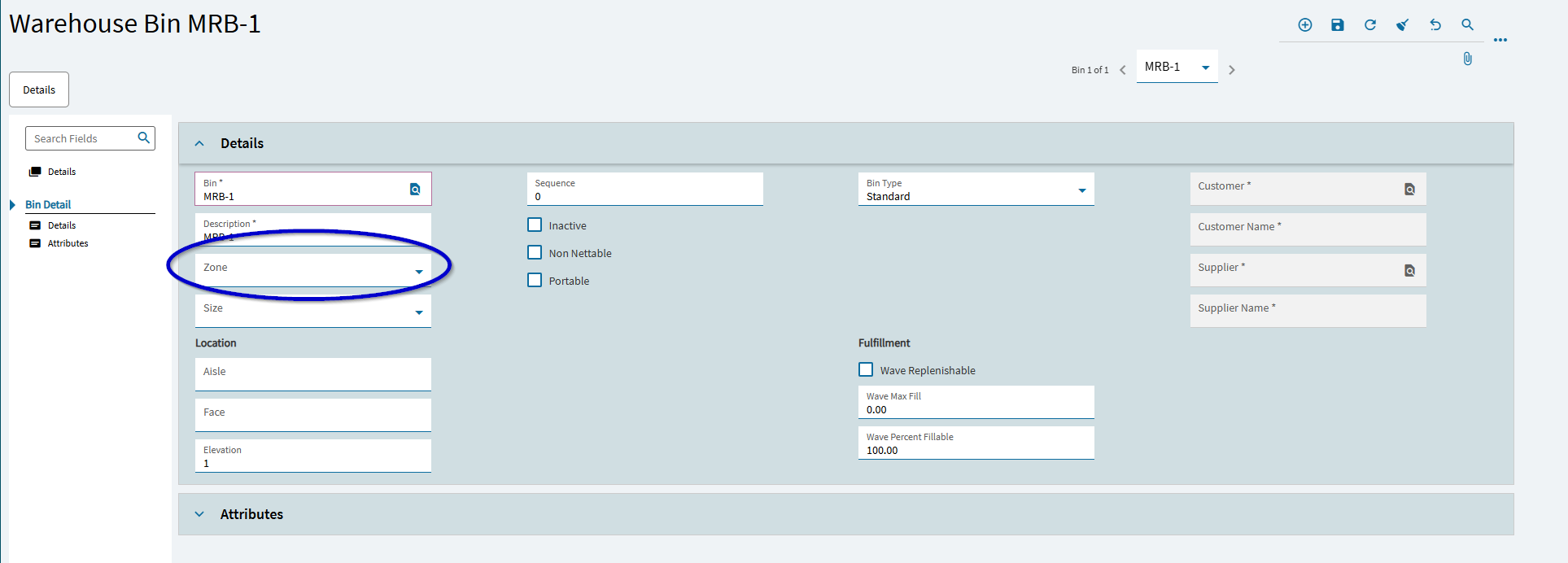

i would probably put the bins into ZONES (see zone maintenance and bin maintenance for the zone fields).
THEN i would write a BPM that would restrict activity against bins that are in those zones to only people in a special security group you define.
