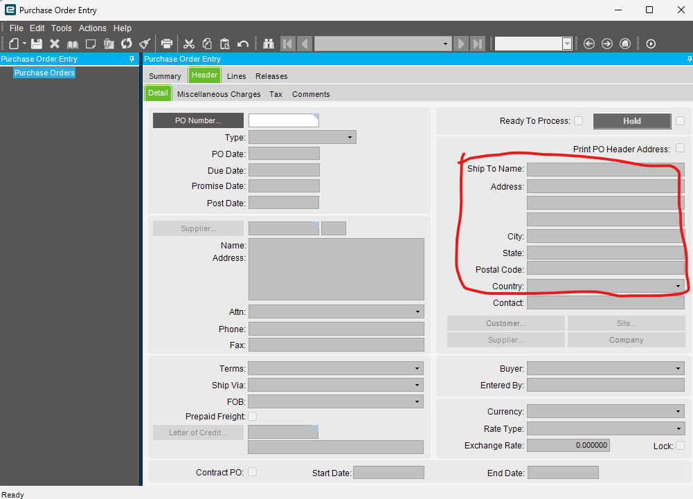

Hello,
Epicor Version: 2024.2.12
Deployment Type: Gov Cloud
Problem: Purchase Order Entry->Header Tab: Need to be able to quickly select between a few addresses. Once the address is selected, it will populate the address to the correct fields for the Ship To section.
Tried: Nothing yet. I have not done anything with drop-down fields so my understanding of them is lacking.
Screen Type: We are still using the modern client at this moment.
What it is related to: Just the Purchase Order Entry at this point.
Code written: Nothing yet. Trying to wrap my head around it before getting in the weeds and heading down the wrong path.
Trying to grasp how to have one drop-down control the population of multiple fields and where to store the addresses in question.
I don’t want to hard code them into a customization.
I just need some guidance on where the addreses should be stored and how to get the population of fields to work.
If you have any other questions, I am happy to answer.

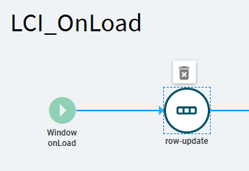

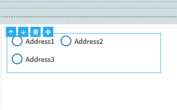

Hi Shawn,
If the values won’t be changed very often or are completely static, a simple selection between these might be just a radio button:
Your value can be the full address, where the label can be an easy identifier:
Ensure that you set the EpBinding. For example, using TransView:
If we want this field to default, we can use a onLoad event to set the value of TransView.AddressSelection:
Then, to actually save this address where you want, just use ā€˜{TransView.AddressSelection}’ in a row-update to the Ep Binding where you require.
If we want the default address for the supplier to populate if this is not touched, then do not default the field in our onLoad event to any of the address selections. Or alternatively, let’s have a radio button option for ā€˜default’. When saving, we can check if our TransView.AddressSelection = defaultValue and if so, save the default address for the supplier.
Hello,
I am sorry but I am not using Kinetic as a front end yet.
We use the client that shows the modern interface (screenshot below).
Nothing of what you said translates for me.
I can see using radio buttons to simply it but after that, I would need the selection to fill in the individual fields with the selected address.
I was hoping to not hard code the addresses into customization as that just makes it more of a pain to change if needed later.
Does that make sense?
