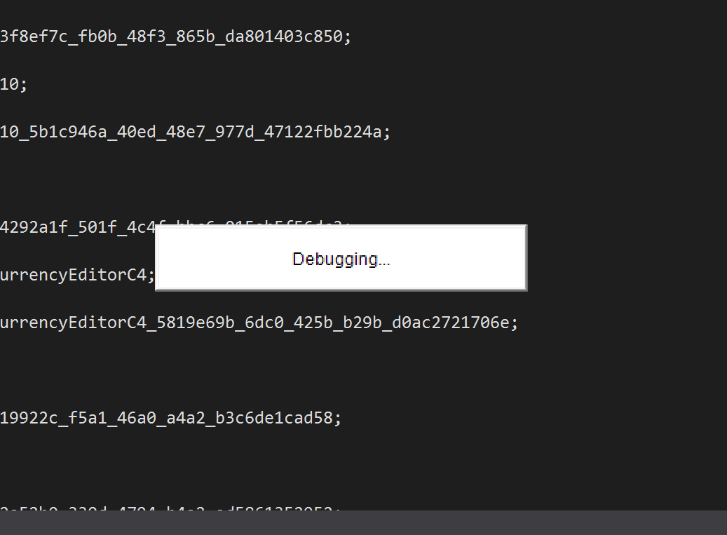

I got it in Visual Studio “the big boy version” and it’s hanging on the debugging part or still processing after an hour. It is a classic form. I should’ve clarified.
Can you clarify that? Hanging on what?
Dumb question here, you did hit “Continue” on the debugging right? It will pause before the screen loads so that you can set your break points, then you continue to get it to load. (I’m assuming you already new that)
But to add to that, if it’s loading the screen that’s the issue, I would add a break point at the beginning on initialize custom code, then start stepping through that. You’ll probably find a loop somewhere and see why it’s taking so long.
Loading slow or slow interaction while using?
@jgiese.wci The customization is slow to load and then when you move the window it loads. But it hangs randomly when searching for orders (Order entry) and other things cause it to hang.
@klincecum Saying it’s debugging in VS.
@Banderson Never got a window that asked to continue or not.

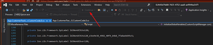

You have to click on this button to continue. It will light up green when it’s waiting for you.
@Banderson … my bad. I don’t use VS much other than to edit reports. Normally in sublime for my IDE. Good to know for the future though. Thank you.

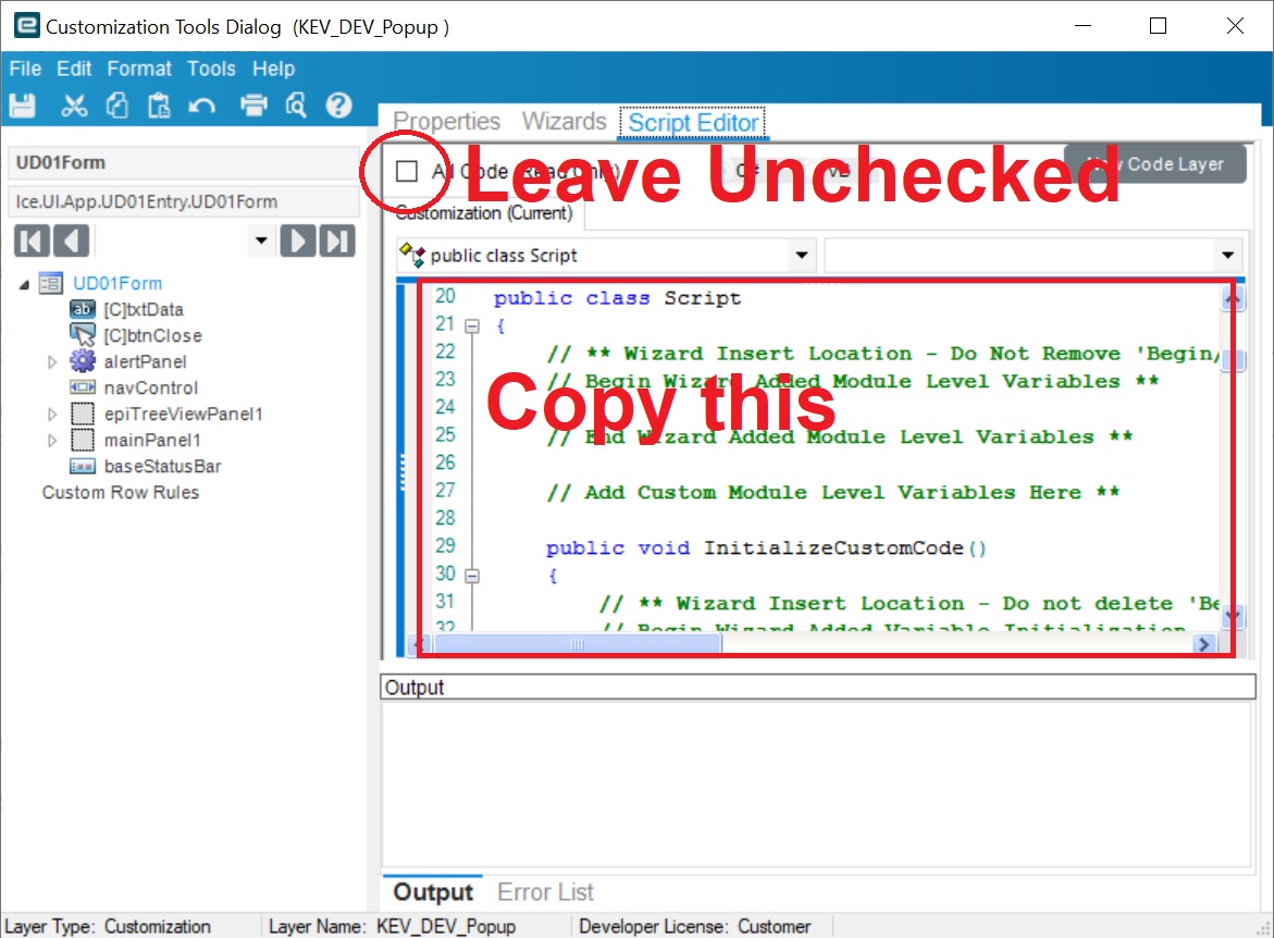

@klincecum This is gonna be super long but here you go.
Also want to note. While debugging and hitting continue, it ends up hanging epicor. I didn’t make this customization so I don’t know too much about it. Base version loads no problem. I cleared all personalizations as well. I gotta split up this response because the code is so long.
And when I try to open the customization window from the “Tools” menu, epicor hangs and I gotta kill it.
